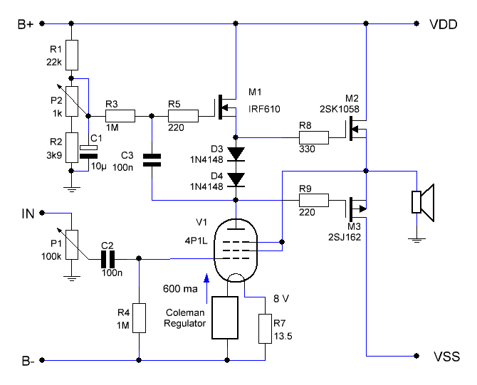

Anything I said made you think I want an effect box? Currently designing an SE DHP driving PP LatFET OPS to mate with the Fostex. Maximizing frequency response and minimal phase shift by avoiding as many reactive elements as possible. Finding ways to measure better in the future to upgrade the effect box into hifi status.You want real effect box?
