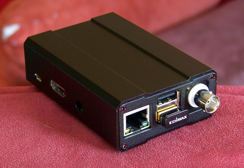

Hi Malefoda,
While you are saving for the next upgrade, and have a few minutes spare are you happy you have exhausted all the setup options for your PiFi Digi+.
I am not familiar with your unit but for instance do you have to use the USB Wi-Fi dongle have you tried an Ethernet connection and turning the Wi-Fi off. Have you tried different sample rates up to 24/192Khz etc. Maybe you could get a few more percentage points out of it. Possibly others would recommend a different PSU over the standard walwart. I guess you have been through most of the related threads, if I am teaching you to suck eggs my appologies.
HI, thanks for that helping hand Raymond.
still have to dig Allo vs HifiBerry. As for Moode I've set it to "don't touch the bits please", I want the ES9018 to do the job.
Right now WiFi is for convenience. In fact on a tiny quality shielded remote port, not like pictured. Ethernet is the default setting but the familiy's rabbit decided to cut the line. Will re-wire soon, as my WiFi is too slow and struggles with 24/96 material.
PSUs were in my scope prior to serious readings, but in the case of a full digital Raspberry, and isolated, it's useless.
Really down to the SPDIF interface now, or later on I2S... but SPDIF at its best does sound great to me.

642646d1509194901-raspberry-pi-spdif-hat-sense-rpi2digi-jpg
NICE box ! ... I have Space Egg blue plastic, of course, but I like yours a lot.
I have a Pi ... But not much sound action with it as yet.
How's the sound on yours doing ?
I see you have a BNC sticking out there ...
... must be your Hi-End 'Pro' SPDIF connector, right ? ;-)
You got an add on card for the Pi then.
Si.
t.S.E.c
Hi... Simon?
That's no more mine, that was a PiFi Digi card and yes integrated with "shoehorn" as we say in french, I guess a tight fit in english (which is close to a fight fit in that case!).
Maybe these were USB ports I've removed, then that "all 75R BNCs at home" connector.
Sound was OK but not as clean/dynamic/real as with the new one.
That non-accurate sample frequency device is gone, I have another tight fit case. And no more WiFi.
Want to see a pic of the Allo Digione intergration of mine?
