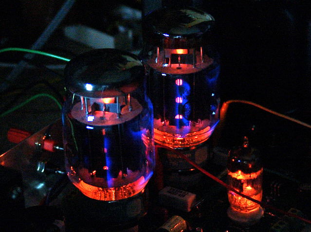

I know this. I picked an operating point that seems to work with 6L6's, EL34's, 6550's and KT88's. The 6L6's run hot, about 28 watts dissipation, only the strong will survive. The EH 6L6GC and Sovtek 6L6WXT work well here and sound the best of all the 6L6 types that I tried. The older Shuguang "coke bottle" tubes show a little color but play amazingly well and have lived for almost 2 years. EL34's all bias up at about 24 watts and work well. Most 6550 and KT88 tubes bias up at around 30 to 35 watts, except for the EH tubes which draw a lot more current and run at 40 to 45 watts. They are not bothered by this and sound the best of all tubes tested if you want to play it loud.
The picture shows a pair being tested at 45 watts dissipation.

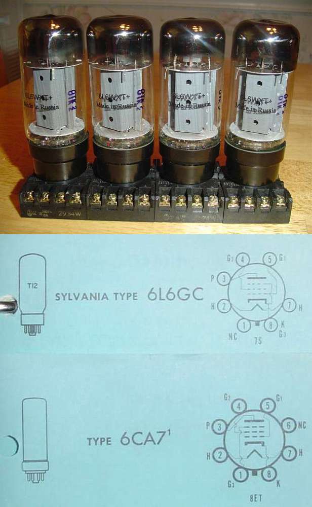

MAybe a little off subject but tonight I blew the dust off one of my ST.70's and tried a quad of Sylvania 6L6CG's that I used to beat to death in my old Bassman. I am surprised that the 6L6 sound as good or better than ANY of my EL34's!😱
Thats interesting I have 3 brand new quads of the Russian 6L6WXT's in my stock and would love to try a set in my Dynaco ST-70. Looking at the data sheet for the 6CA7 and 6L6 (see attachment) the basing is different as the 6L6 has G3 and K tied to pin 8 and the 6CA7 has G3 on pin1 and K on pin 8.
The good thing is G3 and K are tied together on the Dynaco ST-70.
Pyre mentioned he set the bias at 0.410 volts. How did you arrive at that number? Even though I played with tube audio and never designed a tube amp to figure the bias out.
The heater requirements for the 6L6 is .9amps and the 6CA7 is 1.5 amps so that should ease the pain on the power transformer.
