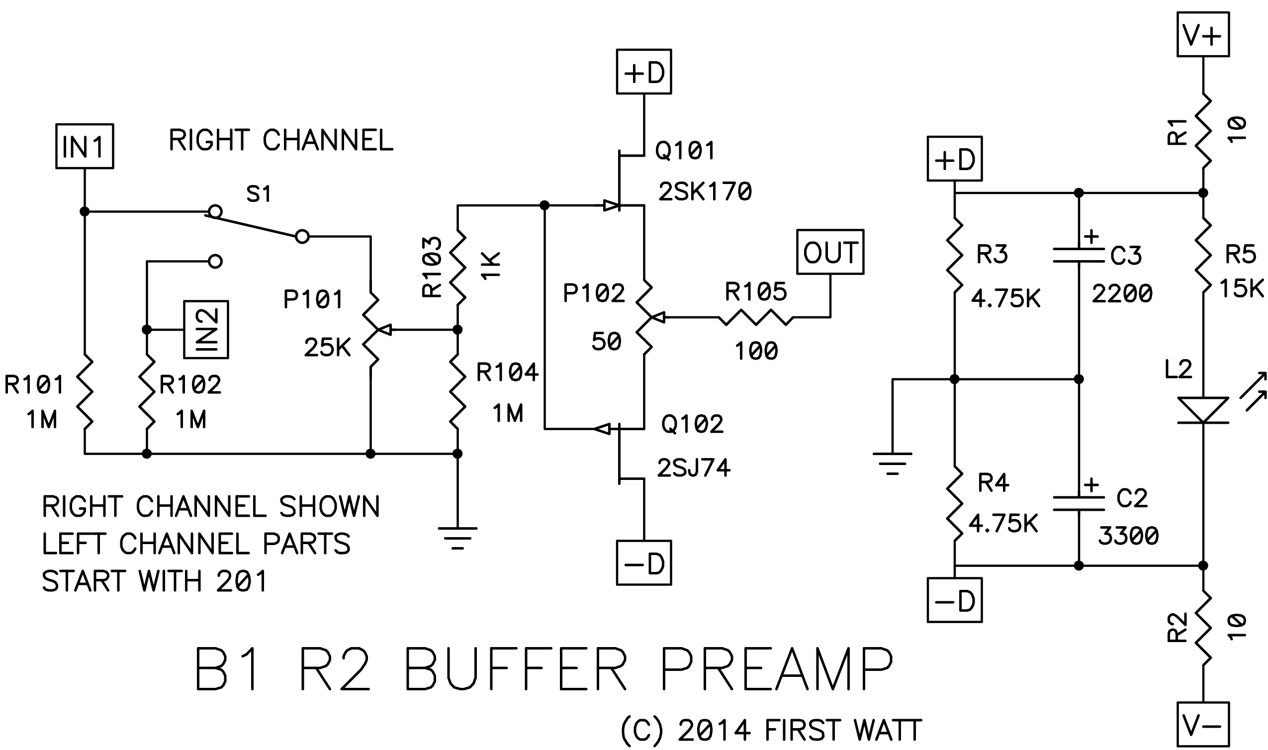

Listed are some simple preamps. There are others, so look around.
I have used BOZ-J and B1 with the F6. BOZ-J has gain, 1 jfet in the path and 1 10uF cap in the output. B1 no gain.
BOZ-J has a little more in the way of bass support than the B1. The B1 is a little more transparent.
Also, there's a B1 rev2 that has no caps in the path.
B1- http://www.diyaudio.com/forums/pass-labs/124889-b1-buffer-preamp-418.html
BOZ-J- see post 2. 10 ohm resistor should be 22 ohm with a 16v power supply, but 10 ohm will still work.
http://www.diyaudio.com/forums/pass-labs/103050-jfet-boz.html
B1 rev2 - see attached.
Vince

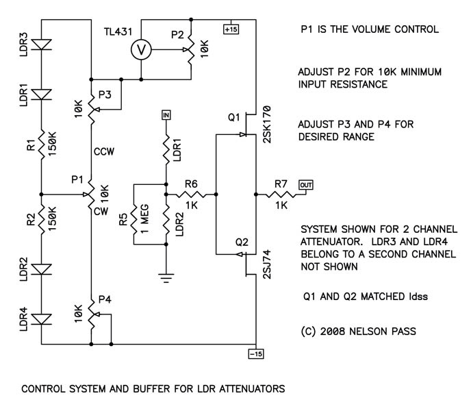

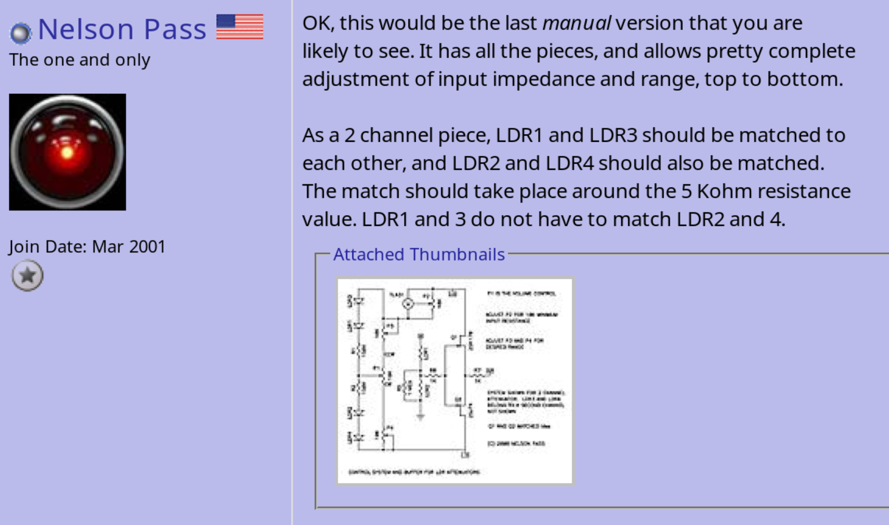

What about this solution presented by Papa ?
Volume control with jfet buffer by light & resistors vactrol
so no physical contacts in audio path like switch or potentiometer.
Copyright and schematic courtesy by Mr Nelson Pass
http://www.diyaudio.com/forums/anal...uator-new-passive-preamp-133.html#post1520215

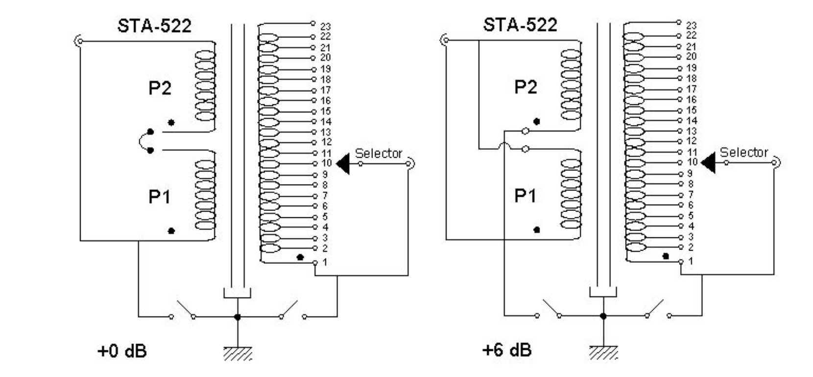

Ok you have DAC with volume potentiometer knob and if connected directly to F6 they need some gain anyway ?
Jfet buffer are great no doubt if necessairy.
Personally i don't use preamplifiers any more transistored or triodes
i change for autoformer volume control
i like gain up stages like was used in M2 with Edcor.
Smaller number of semiconductors in delicate audio signal path.
Really minimal "preamp" ?
just wire on core + 6 dB with transformer volume control

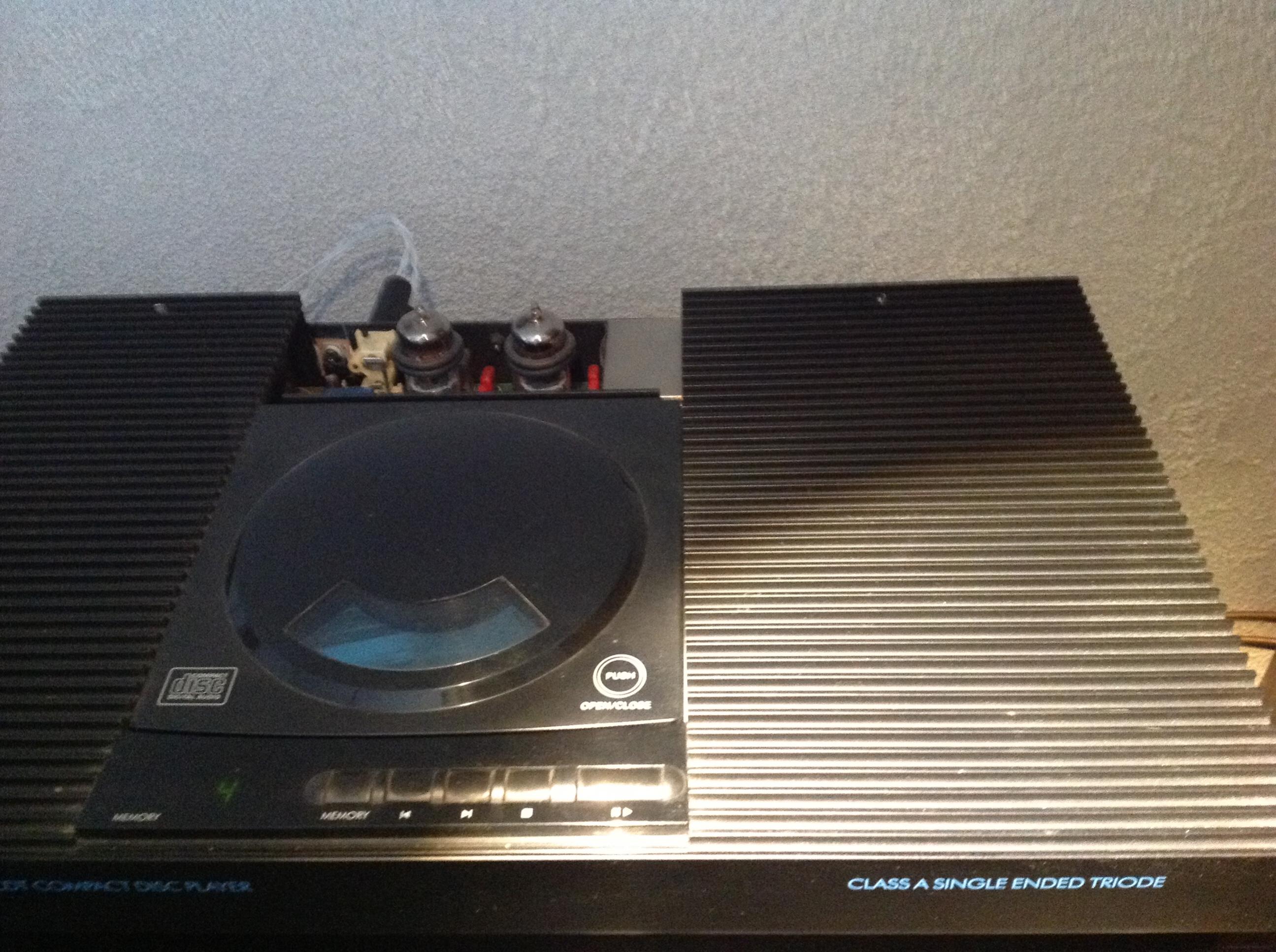

Do you know your DAC analog gain stages are op-amp's ? Volume knob are digital encoder ?
Audio source DAC or CD-player with pure single-ended or push-pull stages
in class A after digital circuit that logic choice for class A F6 amplifier.
Op-amp can have strange harmonic content so if you give them more gain that non garantie it's sound fantastic
I know this situation from my past conclusion non class A glory without adequate DAC or CD-player.
On the photo my actual single-ended CD-player
