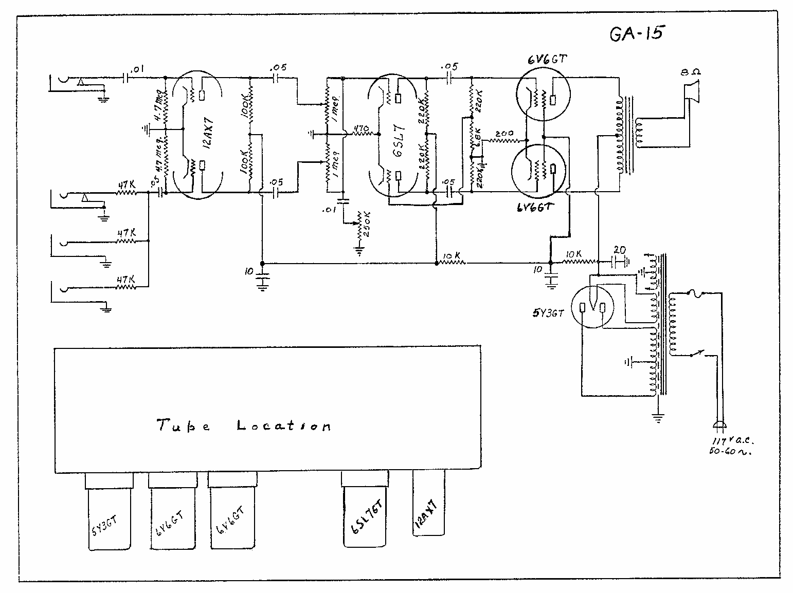

I found what appears to be a better topology for dealing with this blocking distortion and its resulting crossover distortion. One way is to use interstage transformers as a phase splitter driving the output tubes, or so I've been told, I haven't actually tried that. But then you've got to have 2 more expensive transformers, and the amp chassis ends up being rather large.
A friend brought me a mid 1950's Gibson guitar amp to fix one day, and I noticed that it had next to no crossover distortion when jammed well into clipping. It turns out that it has arguably the most primitive version of a phase splitter there is. Same as in the first Fender tweed amp (The Dual Professional from 1948). The phase splitter stage is a simple differential topology. The upper half of the phase splitter has it's plate capacitively coupled to the grid of the upper output tube. After that coupling cap (and this is apparently the trick), the signal is tapped off, resistively attenuated, and fed to the grid of the lower triode of the phase splitter stage, which in turn drives the grid of the lower output tube with capacitive coupling. So the lower phase splitter triode is fed a signal that is in a sense predistorted by the blocking distortion mechanism of the upper output tube, thereby causing a cancellation of the crossover distortion when jammed well into clipping...
If I build another tube amp, I plan to use this topology of phase splitter for driving the output stage. The amp did have a nice sound when over driven with a guitar. Only some of the earliest guitar amps used this topology, so there could be a drawback I don't know of yet (higher pre-clipping distortion or noise issue?), but for a guitar amp I think it's a big plus, and I don't know if the early engineers realized that they had this feature. Not everyone cares what happens beyond clipping. I do.
I've attached the Gibson circuit.

Yep, the old "paraphase" PI.
It seems that the "top" unit's plate would have to see the distortion caused by the grid current of the corresponding 6V6, which it would, and feed it to the "lower" unit. That lower unit's distortion products are not fed back to the top unit, nor to the upper 6V6's grid But that lower unit is also seeing grid current caused distortion due to its corresponding 6V6. Got to think about all that, considering the out of phase displacements, etc. In my case, this is for Hi Fi so I simply don't want to get into clipping deliberately. The concern is when it happens accidentally and how well the amplifier recovers.
