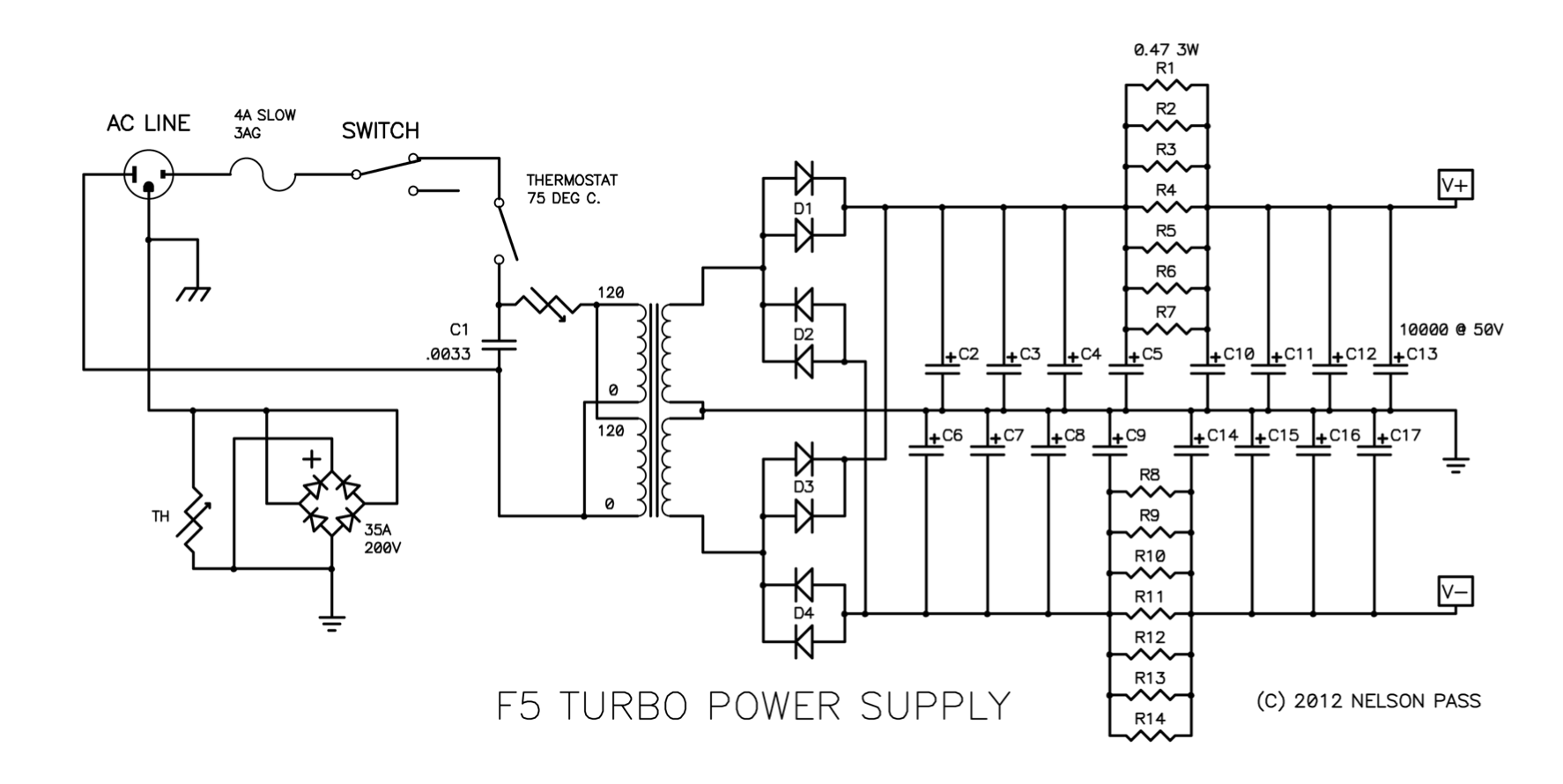

Which amp you gone build? What will be the bias current? What will be max power? What is the psrr of the amp? What do you main with best? I know a lot of questions. But there are a lot of solutions.Hello Dyers, I`m looking for the best possible schematics for the above, I'm going to build a power amp in class A and I want to know, which PSU is considered the best, and why ? Thanks !
erm we have some nice designs in here , but still we are looking for the best guys ! Some mosfets to get some juice or not ?
Properly done, linear regulation has to go beyond the cursory requirements of the amplifier ratings. The regulator should be capable of ten times the current of the continuous output of the amplifier channel.The regulator should be preceded and followed by large capacitances with values comparable to those needed for unregulated circuits. The transformer size still needs to be as big as that used in an unregulated circuit. Approached in this manner, linear active regulation delivers the goods.
Have you read Nelson's thoughts on this from his Power Supply paper?
amp is mine invention nothing fancy 2 pp with 2SC5200/2SA1943 , power is not a factor here , aiming for a cleaner signal so i really do not care about , desired voltages to be powered around +35 to -35 V , BEST for me is less distortion and true bass 😉Which amp you gone build? What will be the bias current? What will be max power? What is the psrr of the amp? What do you main with best? I know a lot of questions. But there are a lot of solutions.
I am going to test one with a 19,5v laptop PSU. With a 4700uF capacitor most of the 40kHz ripple will be gone.
I did count with 0,1 ohm 7 uH in the cable. Output 4w 8 ohm wich is enough for a pair of desktop speaker at my monitors.
Early Adcom 5200 and 5300 had common rails (with front end separated by just RC), but then later 5200 and 5300 got separate L and R front end (with higher V) and OS windings, which is a BIG improvement.It is not the output of an amplifier that needs a cleaner supply
it is often the input
