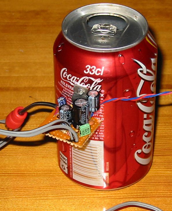

I have also made my 1st chip amp. It's very low budget with a TDA2003 I bought years ago and with cheap standard components. It sounds but it's offcausse far from good hifi.
see the picture, note the heatsink;)
Wonder whats the worst of the design? Components too narrow? poor pcb? cheap components?

What is the sch. that you use? I think it may has to do with the IC and the specific sch. and PS. Parts too, but I'd start with the speciffic sch. Use LM1875 and 18-0-18VAC with Pnasonic FC caps and normal resistors. If you can avoid the el. caps at the input and the NFB that's the best IMHO. How sensitive are your speakers? You may need more power than 12V can provide.

For this quick-and-dirty-allways-learn-something project on the picture I used the "typical configuration" scheme on the TDA2003 datasheet. At this point I regret I did the layout so narrow. It makes it difficult to rebuild and test different modifications.
If I understand it right your opinion is that significant improvements can be made by using an other scheme.
Since my preamp have capacitors on the outputs I think it will be no problem to skip the caps at the input.
I have not yet decided which scheme I will use on my more serious attempt with the LM1875:s, but it will be with some kind of plastic caps in the NFB.

If the LM1875's not available, you might try the TDA2050; I recently built a TDA2030A and it's sound is significantly better than I thought it would be. I'd still rate my 2A3 as sounding better (given the disparity in costs, I'd be crushed if the reverse was the case!) but I can listen to my TDA2030A all day long without fatigue and better yet I can even enjoy the music through it (not possible on some systems!).

PS. Love the heatsink! :) I wish I would've thought of it! ;)

and Mr Evil: The tda 2005 is'nt worth the printcard it's slderd to.
it really is a horibly sounding thing, at least acording to my ears.
built an amp based around this chip last year at school. not the best design or quality parts, but still: it was beaten massivly by my lm3886 amp.
tda fan.
the tda 2003 is usualy used with battery power, could be one of the reasons its sound quality wasnt up to much. ive built a few tda2030 amps, and even with just a 25va transfo, running single supply its sound is equal to that of my sherwood 5.1 system, not as loud of course but good sound running into audax ap130g2 speakers.
