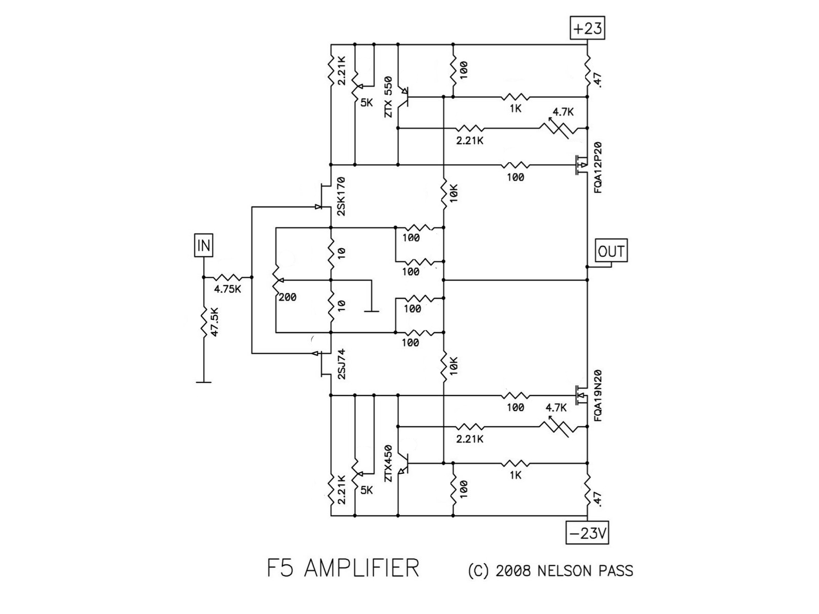

I am trying to pick a MOSFET to use in a Class A design. Most of the recommendations I have found thus far on the forum are considered obsolete by vendors. What do you prefer that is still available?
A lot of commercial amp models use custom made versions - not listed by mouser etc - e.g. SANKEN's MLE20 - go to
https://www.diyaudio.com/community/threads/yamahas-new-floating-and-balanced-power-amplifier.290584/

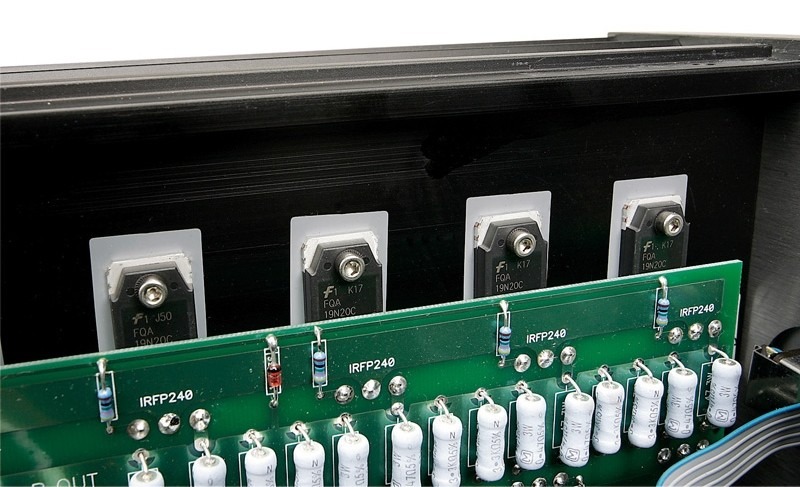

Mr. Nelson Pass seems to be prefer still the use of good available MOSFET versions from trusted brands - go to
https://www.moremusic.nl/reviews/passlabs/INT-25/review-PassLabs-INT-25-Stereo.pdf
and the attached images.
He can certainly give you the best recommendations on which MOSFET's and which brands to prefer.
