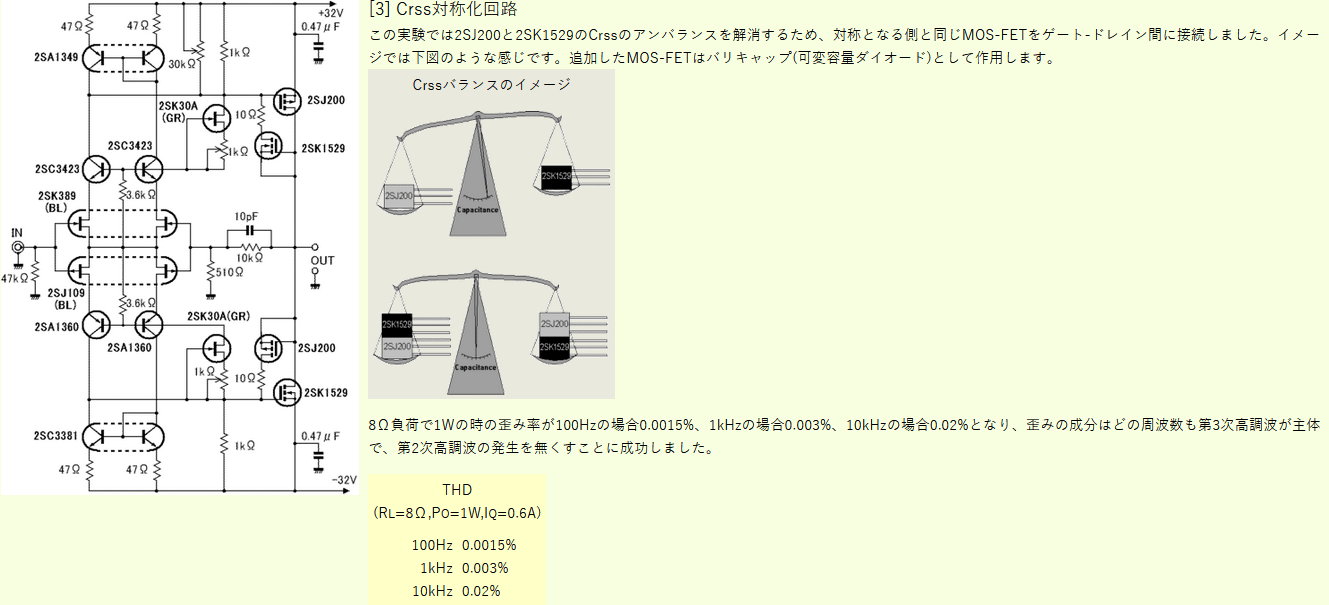

It seems that 510 and 9520 are a match for transconductance, and one can add a small cap to the N channel gate/source to aproximately match capacitances. Harris parts are preferred (this was discussed extensively on this forum, there's a flaw with the IRF P channel).
