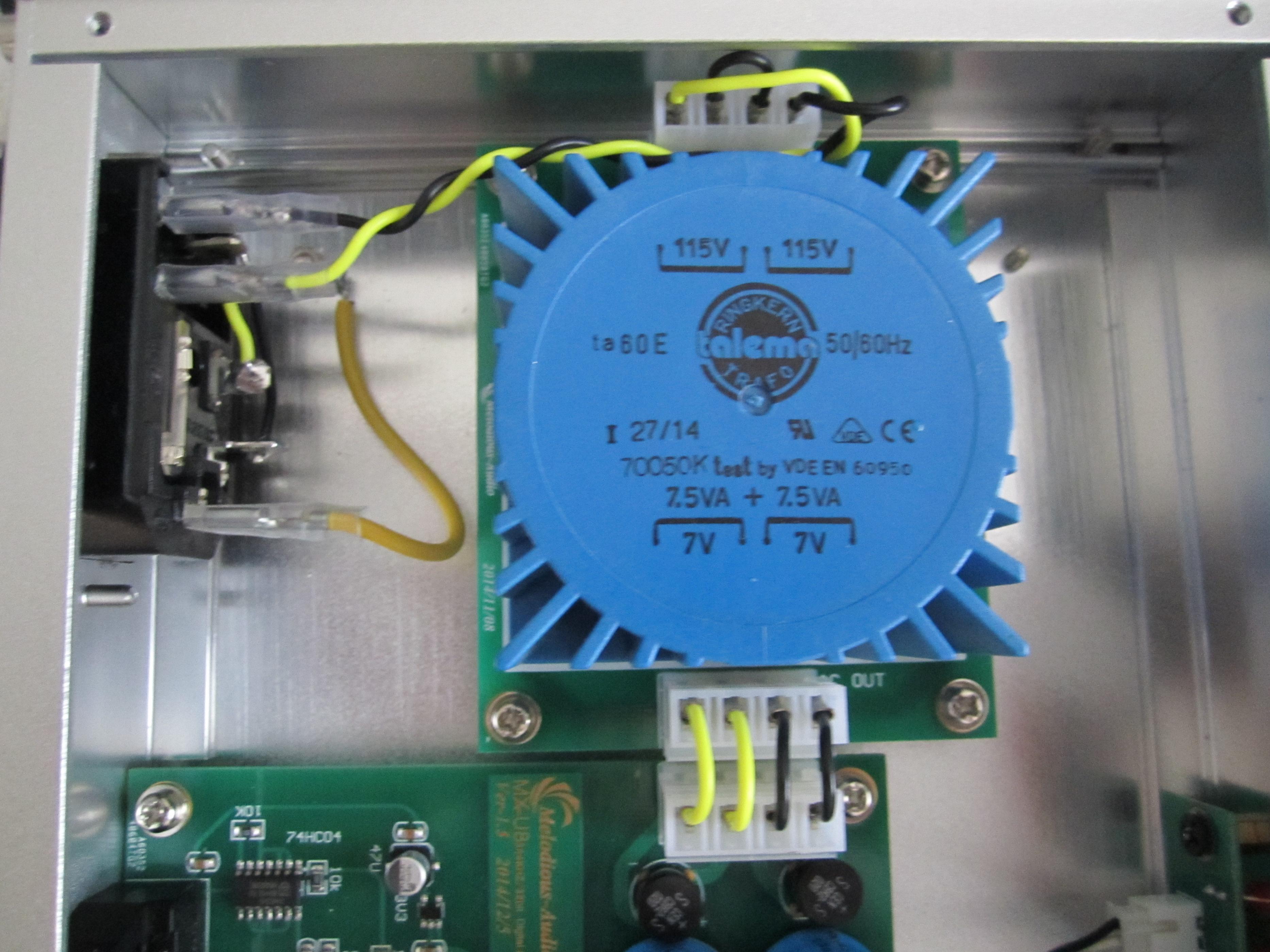

I am attaching the stock power supply of the unit ... it is plain ridiculous.
No mains filtering ... poor diodes bridges ... they could have done much much better ... this one i am able to design also myself. And i said all.
I would like to replace everything up to the smoothing caps after the bridges.
And this implies to provide very very very clean DC to the caps before the regulator.
This is the situation ... not nice at all.
Would you live with such basic ps ? i do not think so.

well you have a perfect solution 2x18650 series batteries > into a LDO at 5V,
those 2 batteries should last many hours or days before charging.
but then you start flipping around again, try it and then see. either that or build some test equipment to amplify AC noise from DC supplies or youll never be satisfied.

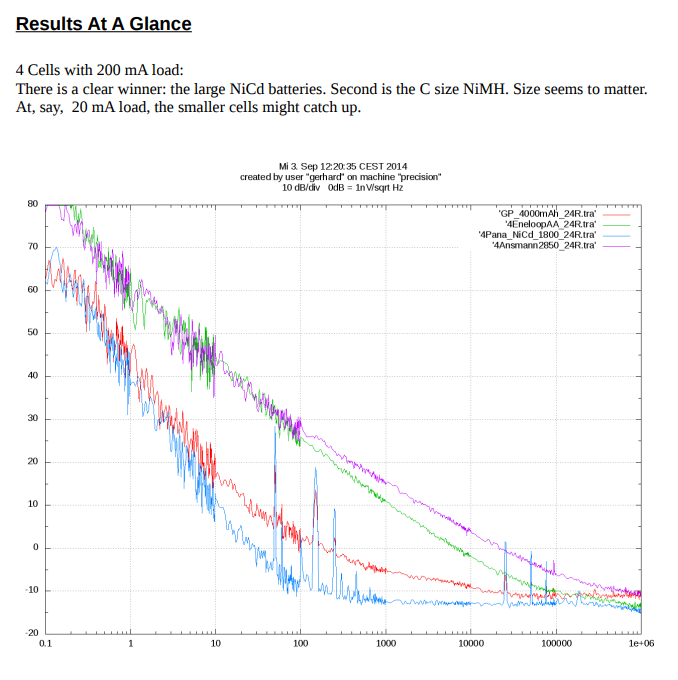

Gerhard Hoffman is a regular forum contributor, did some analysis of noise in batteries -- this chart sums it up. The entire paper can be found here: http://www.hoffmann-hochfrequenz.de/downloads/NoiseMeasurementsOnChemicalBatteries.pdf
Me, I am using a pair of 18650's to power one of Jan Didden's Silent Switcher's. This gives me +/- 15V at 150mA
