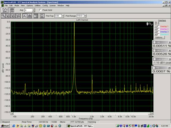

Best opamp for I/V conversion? (DAC)
What's wrong with passive I/V
This is a balanced PCM1704K with a resistor between the inverted and non inverted dac.
The 150Hz spike is there independant of input and the 2 kHz -88dB is identical to what I get from my DENON 2900 line out (PCM 1792 with opamp I/V and supposed to measure -101dB THD @ 1kHz) which makes it likely that the soundcard creates the -88dB 2kHz harmonic.
The visible difference compared to the denon was less harmonics above 2kHz with my Balanced PCM1704 passive I/V dac.
If I had a better soundcard I would not (now) be surpriced if the passive I/V actually measured very close to or on spec with the PCM 1704K.
