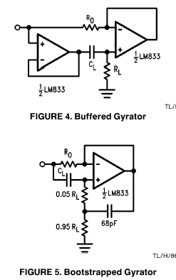

MurrayP, the circuit you have used is rather classical. The opamps (the lower ones) serves as simulated inductors. The cause rather much distortion and it's important that the opamps are rather fast otherwise the "inductor effect" gets reduced. But since the frequency is only around 100 Hz, I think the application isn't so demanding.
Rod Elliott has made the simpliest form a gyrator (simulated inductor).
You could make it bootstrapped and/or buffered. See application note from National.
AN-435
AN-435

Back on track the simulated inductors Do work better with High speed Op Amps i use Video grade devices by default for these at all frequencies in the Audio range. Also current sourcing the Output is also a good thing with this circuit.
