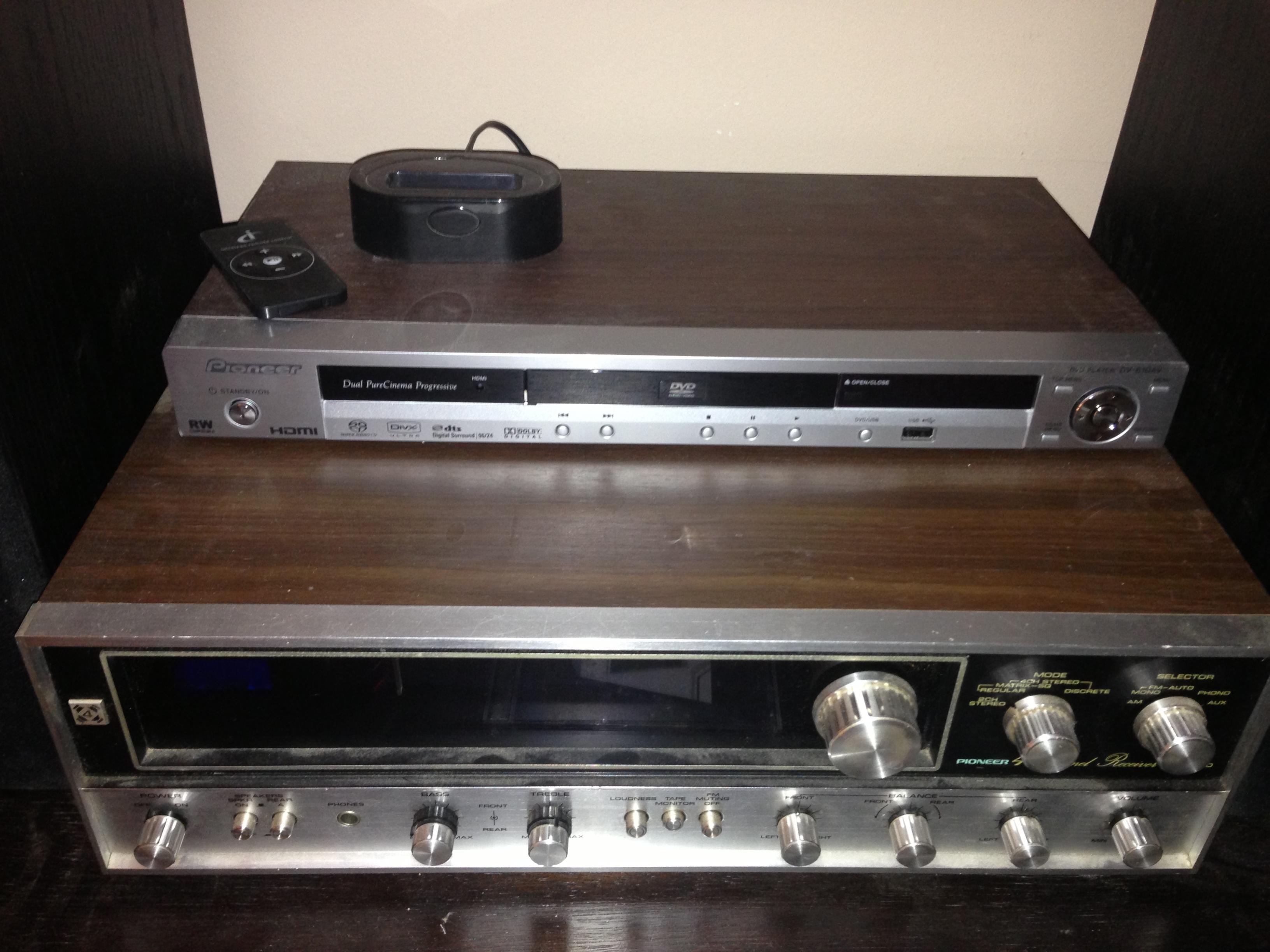

I bought some cheap vinyl sticker stuff off of eBay, and used it to cover my DVD player (which I use for SACD/DVDA/CD). I wanted it to match the wood case of my vintage Pioneer QX4000 receiver.
It actually looks really good, and a giant roll of the stuff was under $10. (Enough to do 3 CD players easily). You'll need a flat surface, so for your speakers just use a little spackle and a putty knife, then lightly sand. Then put new vinyl over.
Pic of my bedroom stereo included below. (The one on the top is the fake vinyl stuff, the receiver has actual wood)
