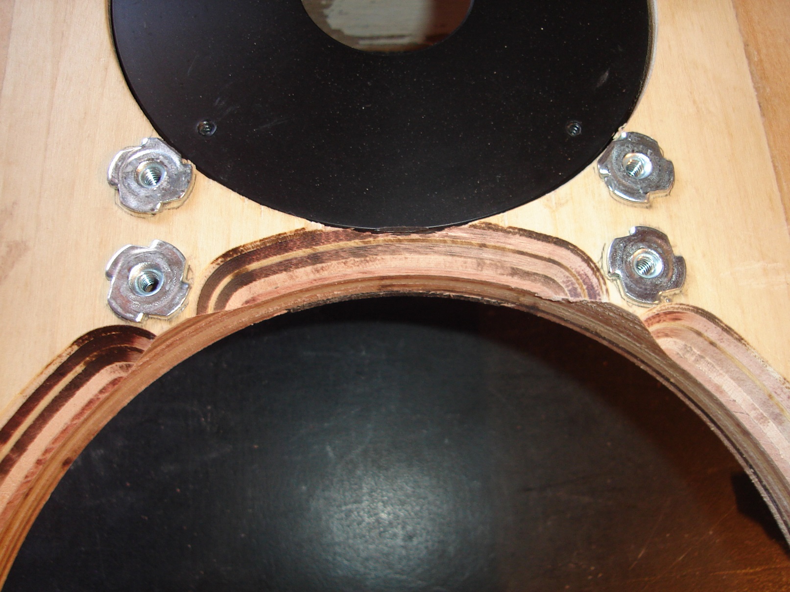

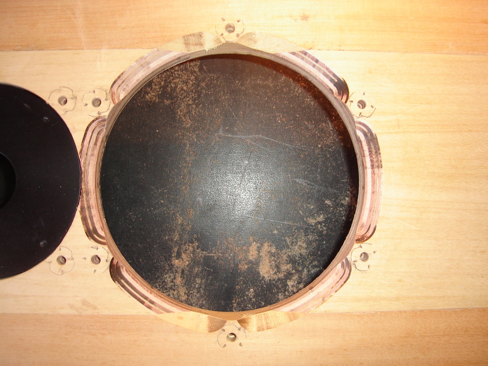

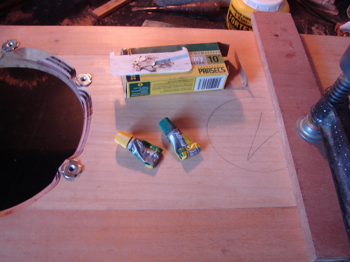

My solution (when I used them) was to make some small holes as a guide so that the eyelashes do not bend.
And epoxy resin before nailing them.
Then I decided to use common wood screws, the trick is to make the hole a bit smaller, remove the screw, and apply synthetic glue to seal the threads. But this is not my invention .....
See : " Screws for mounting drivers "

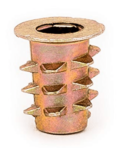

I have used the E-Z LOK - 901032 threaded inserts very often for attaching furniture legs and also woofers. See photo. I like them very much, but mostly that's been in 3/4" ply. They come in different sizes of course, and also without the flange (I think)
I recently used some of the brass threaded inserts from Lowes. They look very pretty and have nice threads, but I found them much more difficult to use than the E-Z LOK.

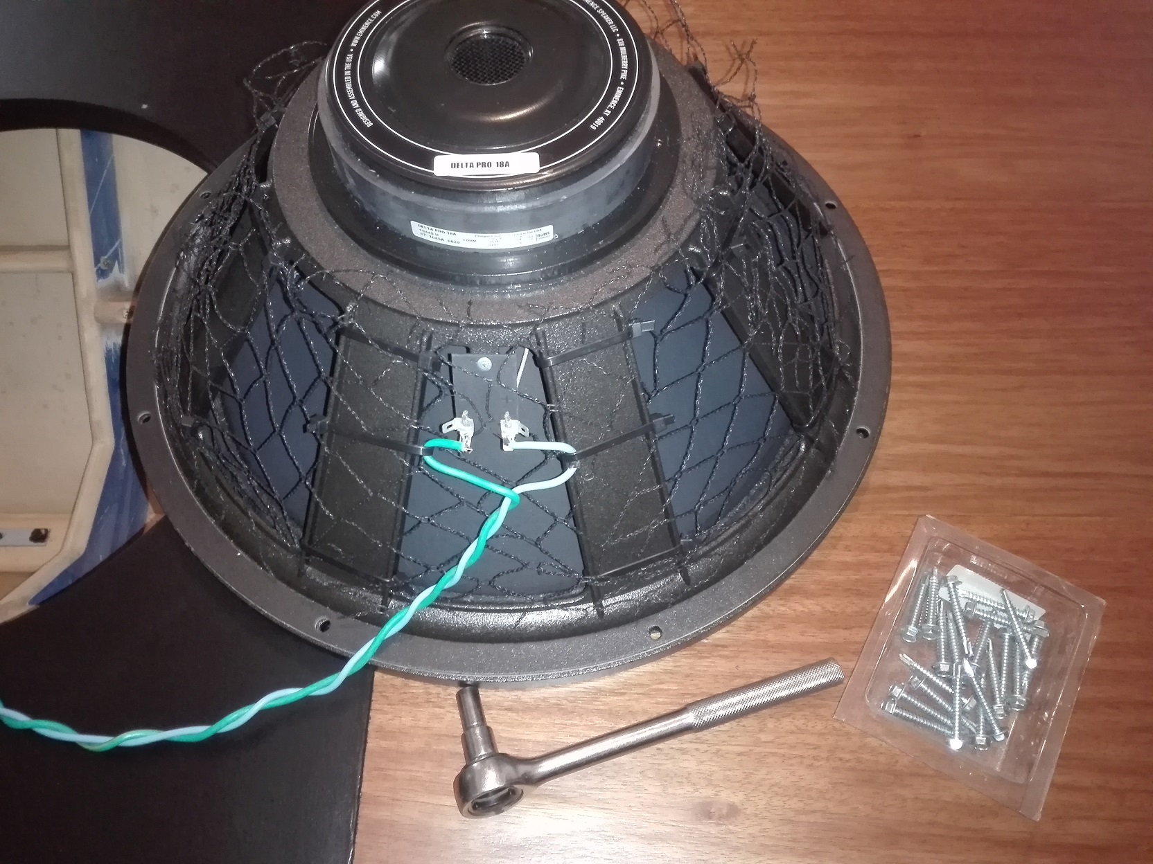

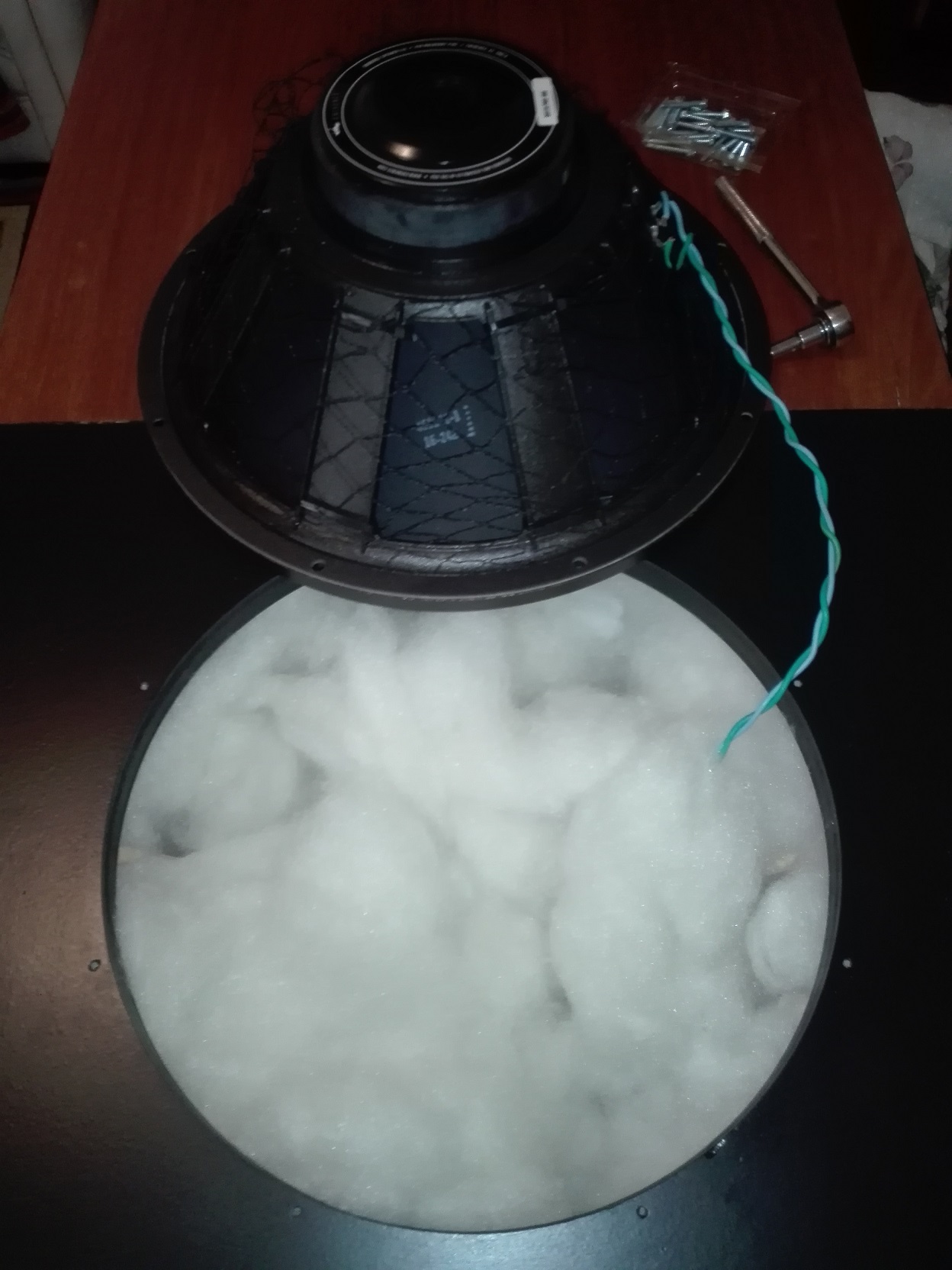

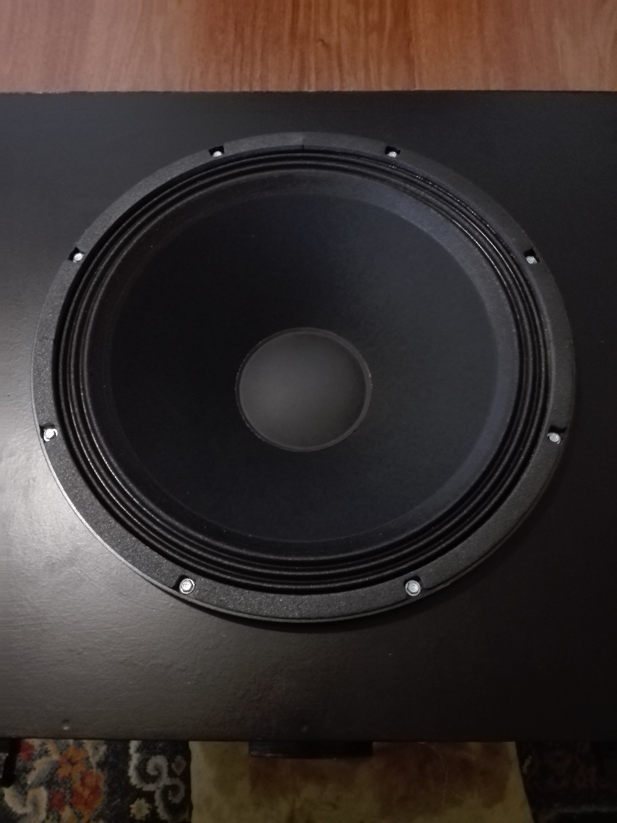

Here the installation of 18 " twoofers, the screws are used to fix roof sheets, they are" self-drilling ", but it was a very great risk that a bad maneuver would break the speaker cone.
So I made the previous hole, I put the screws fully, took them out and applied vinyl glue. Once dry, I screwed everything with a cricket wrench. In this case, the MDF is 30mm. I had put the net that you can see in the photos so that the polyfill did not interfere with the movement of the cone. A short time ago I decided to remove this net and the plastic seals, because the speaker would have already molded into the filling material and I had been left with the idea that the seals could loosen (that part of the basket is slightly trapezoidal).
In short, the screws were put in and out four times and the "threads" did not suffer any damage. So the method is efficient, and much simpler than any type of insert or "T" nuts. 😉
