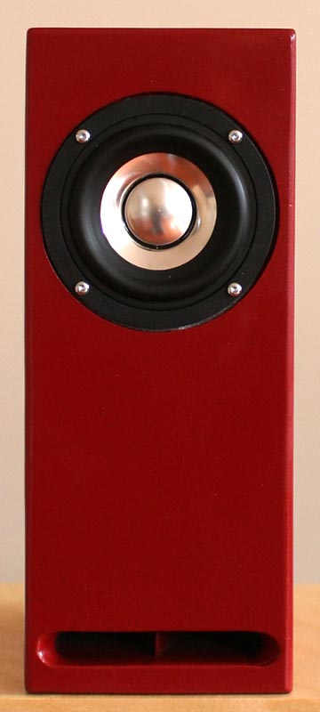

+1 on the fullrange driver for desktop application. Here's what I currently run:
Fostex FF125K in a small bass-reflex. This is not a good enclosure for it if you are not nearfield. The alignment is over-damped, which produces satisfyingly deep and smooth bass at the seated position, with the wall/desktop boundary loads.
For something available right now, I'd like to try any of the small FF-WK's.
