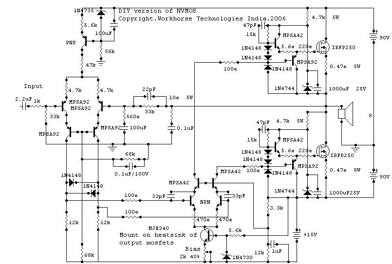

I Disagree that having n-channel outputs the upper is follower and lower becomes CFP.
Also what exactly you term as quasi-complementary, by just having N-channel polarity of devices at outputs doesn't means that amp is quasi-complementary.
What will you say if the open loop gain and voltage swing of both half polarities will match under 0.5% for a given pair of device, do it with so called complementary mosfets, you will see the differnce in current waveform
The traditional way of using a pnp transistor as phase splitter/driver for negative rail device as in old bipolar design is not the way of doing N-channel amplifier.
The costly Toshibas 2SJ201/2SK1530[esoteric novelty of just 200V rating] and IRF old horses 240/9240[punny current rating of p-channel forces you to uses much more devices] you are talking about is used by everyone who want to claim that they have made a Mosfet amplifier.
One single pair of IRF260 N-channel amp will kick a 3 pair complementary amp made from 240/9240 out of the job.
Which way are you doing if you dont use pnp transistor as phase splitter/driver for negative rail device
can you offer sample schematic ?
Try to think out of the box, don't get swayed by traditional flawed design approaches used for bjts to serve for n-channels also, search the forum, there are plenty of designs which dont use the UGLY PNP PHASE SPLITTER APPROACH
for a simple rookie example have a look at this
http://www.diyaudio.com/forums/attachments/solid-state/65532d1150022131-nvmos-amplifier-ampdiy.jpg
