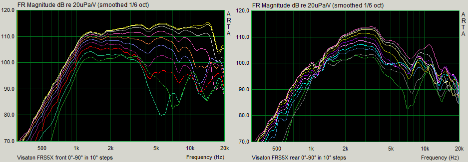

2" Visaton FRS5X usable 1,5-4,5 khz
(Frontside Backside Pattern: https://www.diyaudio.com/forums/att...ectivity-dipole-tweeters-frs5x-front-rear-gif)

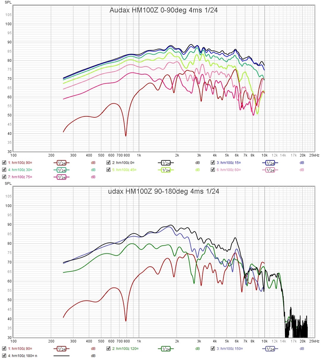

4" Audax HM100Z0 usable till 1,5khz
(Frontside Bacside Pattern:
https://www.diyaudio.com/forums/att...9848301-3-ob-hm100z-0-90-180-4ms-124-vert-jpg)

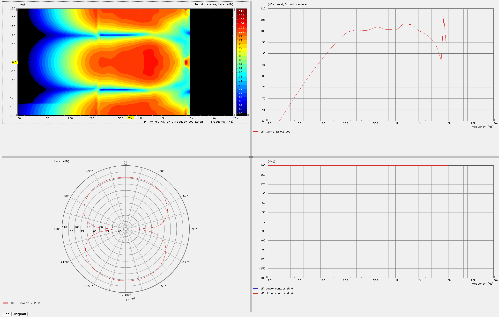

I has no direct 15M/4624G00 polar plot measurements, but I has Akabak simulation on triangular MTM baffle at tweeter axis/level.
