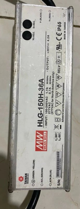

I use refurbished HLG-150H-36A for my V3 mono and working flawlessly, no noise or anything, it doesnt have fan either, yes its only 36v (run the amp cooler and less distortion than 48v) and not new...but for less than $7, there's zero complaint....

I would think the HLG-150H-36A is a bit light weight for a 3255 unless not having much energy for serious bass, there than that probably great.

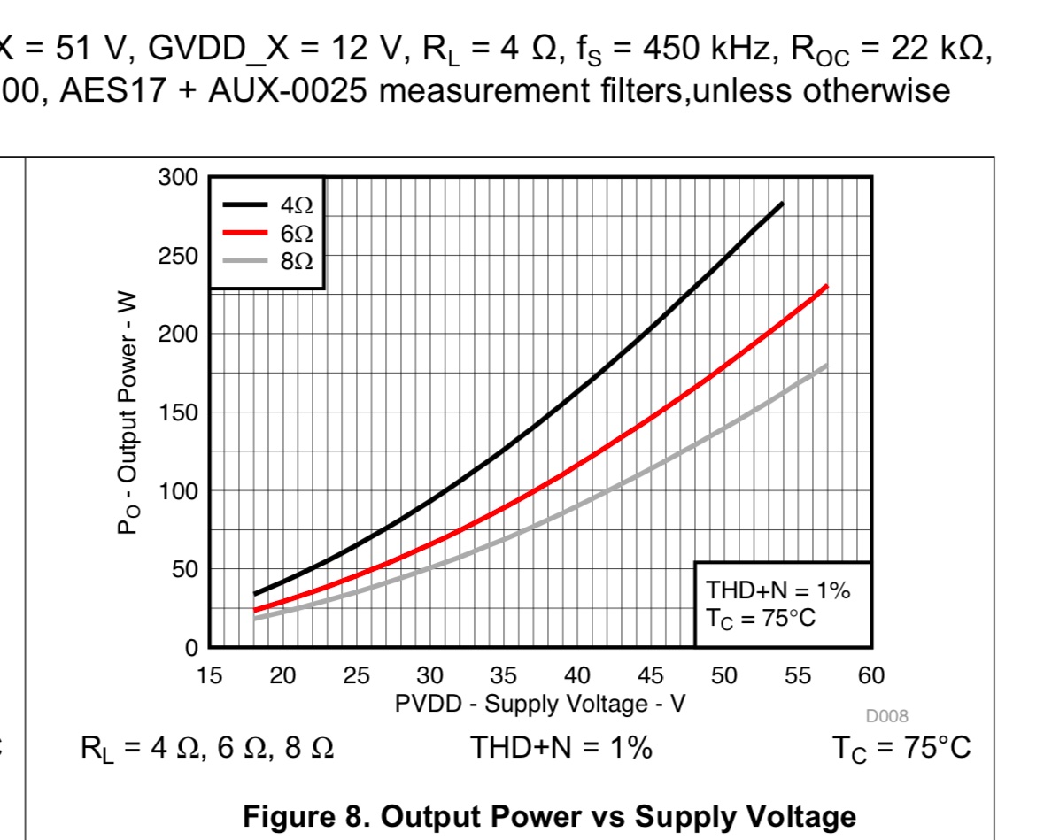

If you look at the datasheet for the TPA3255, you can see a graph of the input voltage vs the output power for various speaker impedance. I would look at that and try to determine the lowest voltage you can use that still meets your power requirements. Most of the various boards I have seen tend to have 50V capacitors on the rails, so for me running 48V on one of those is asking for trouble. I personally plan to run 36V on my subwoofer plate amp that will use the same chip.

Thanks, much appreciated!
The za3 has 63 volt caps so can handle a bit more PS voltage, not sure about the future higher end builds I want to play with but I can always build with or swap to higher voltage caps if needed.
Speakers I am building will be around 6 ohms, subs around 4 ohms, not considering actual measurements and curve.
Have you tried 48 volts, or so, compared to 32, 36, etc to see if any difference in in the sound quality of the output? I do not care so much about measurements as I do about actual audible differences.
