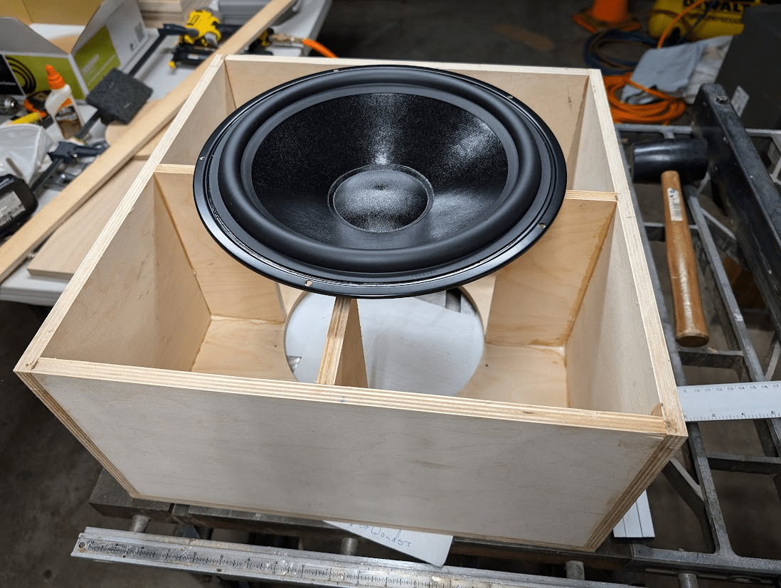

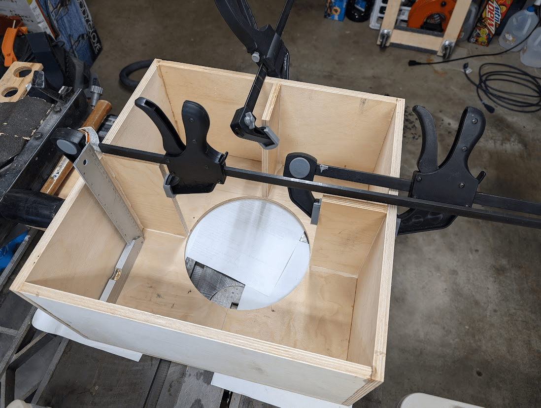

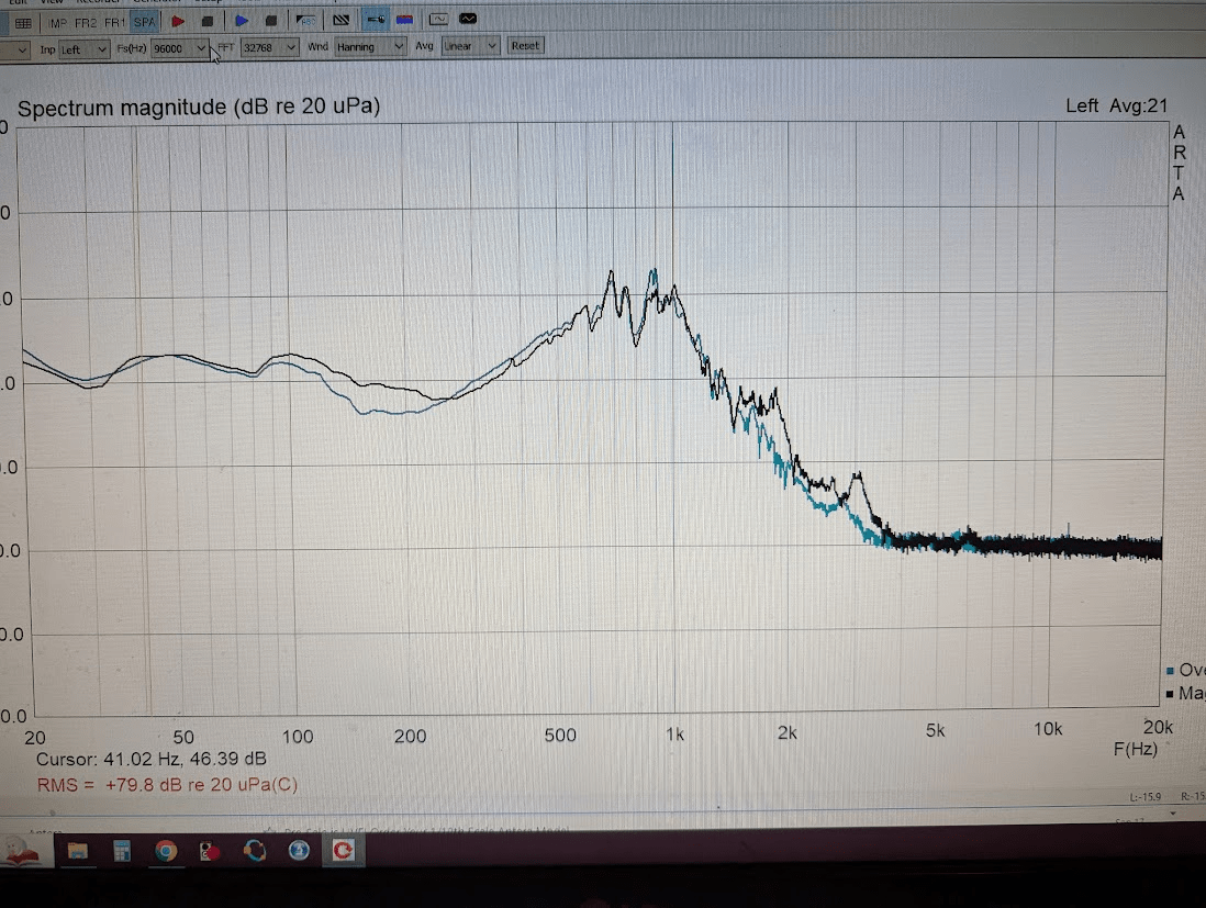

This week I am in the fight building four boxes with 10" woofers. I selected 12 mm Baltic Birch plywood. My goal is to have a finished speaker at about 9 kg (20 Lbs.) so I can lift it following a back injury last year. I am planning to use a crossover around 400Hz, so the goal was to get the lowest panel resonance above 800 Hz. I added four simple braces to segment the side panels in half and the front panels in quarters. I have yet to open the hole for the passive radiator in the back panel. I have yet to put any acoustic foam, fiberglass or foil covered butyl damping against the panels. It looks like I'm around 700 Hz with a high Q currently. My local lumber yard had 5' x 5' sheets and they deliver for a small fee. The box is 17" x 17" x 9".
Here's the measured PSD measured with me knocking centered between the braces on the side panel.
Here are the braces and checking the fit of the 12" passive radiator. Ah the smell of sawdust in the morning!
