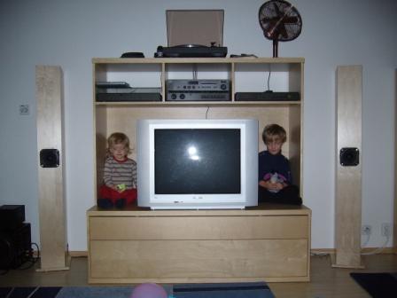

Love all the kid pics... mine are 6 and 8... they just got their green belts in karate over the weekend.
http://www.zillaspeak.com/bib-godzillabib.asp
scroll to the bottom to see my kiddies.

Hey there's a pair of handsome little men.🙂
Zilla, mine are 6 & 9.

peterbrorsson said:He he, so speak the scarred ones😀
Well uh, gee uh, I prefer to call it wise ones Peter.😉
Rick
It's nice wood anyway, however it's not my cup of arsenic. I'm Scandinavian and blond wood is preferred here. As I'm working everyday with wood I can appreciate it anyway!
I love figured maple with a natural finish. I'm partial to blonds too.😀
You mentioned working with wood daily Peter, what exactly are you doing?
Rick
I'm developing stain and laqcuers for industrial use. Nowadays it's mainly veneers due to cost savings. I'm no wood worker by all means. Just a happy amateur trying to do my best.
