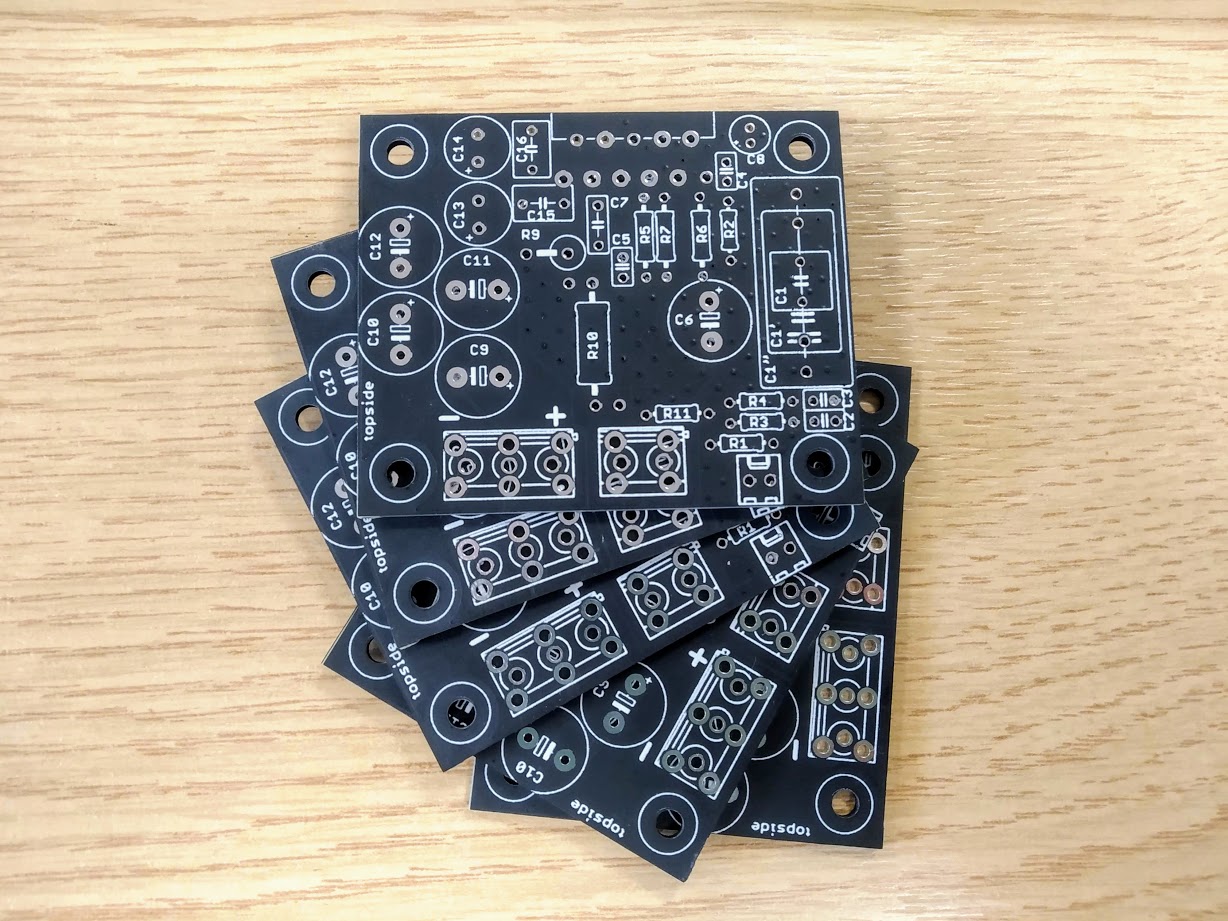

I've ordered 5 of 00940's layouts from JLCPCB, I'll build four of them & then see how close the DC offsets are & what lengths I need to go to in order to successfully parallel 2 of them. Thinking about this I now understand better why Crown Macrotechs used to have their TO-3 output devices colour coded or numbered in the factory, according to their tolerances, so that the amps supported parallel mono operation in addition to bridged mono. I've been looking through the thread on 00940's layout but I've not yet come across a list of recommended component values?

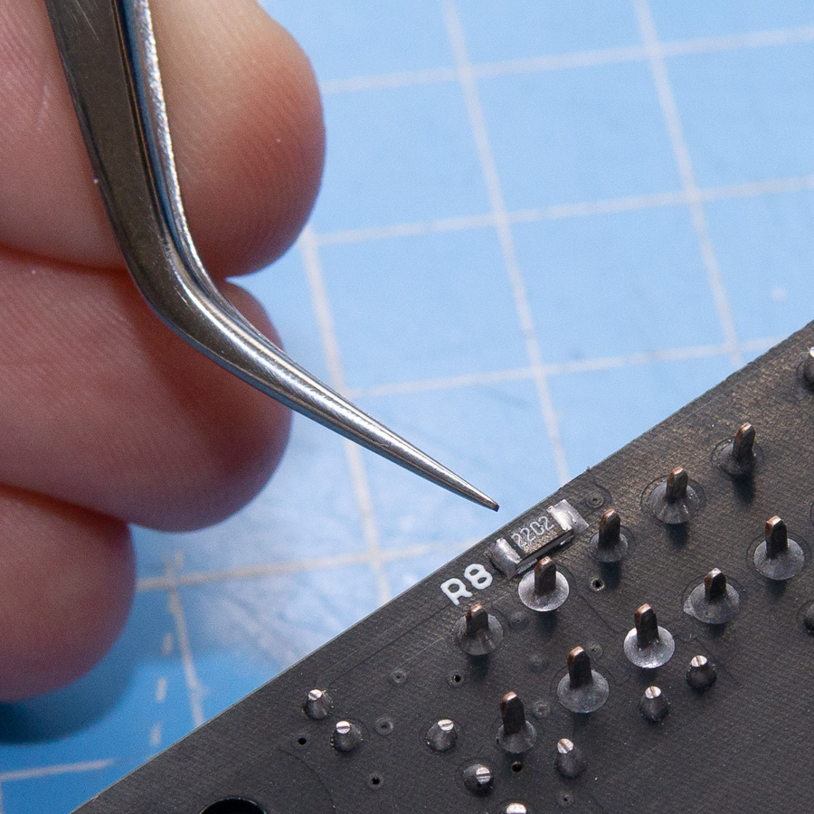

PCBs arrived from JLCPCB, components from Mouser should get here on Monday. The aforementioned BOM is missing the SMD resistor R8 for the bottom of the board, so I ordered these which I'm pretty sure are the correct size;
CRCW120622K0FKEA Vishay / Dale | Mouser United Kingdom

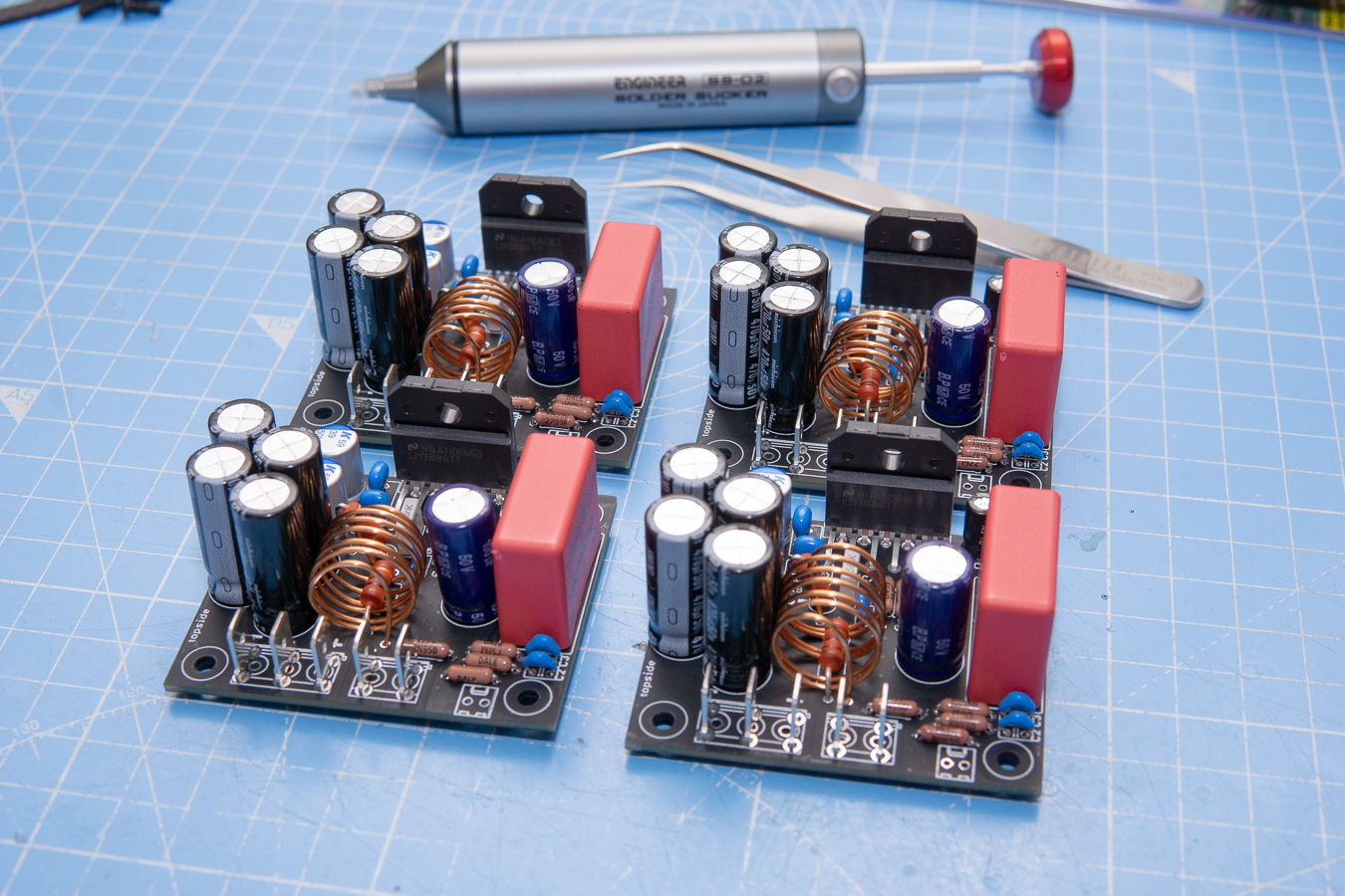

It's been a while, but I've finally made some progress. First time soldering SMD but it was pretty straightforward with a decent pair of curved titanium tweezers.
Just to double check, I'm fine to power the amps without a speaker attached in order to measure the DC offset, correct?
