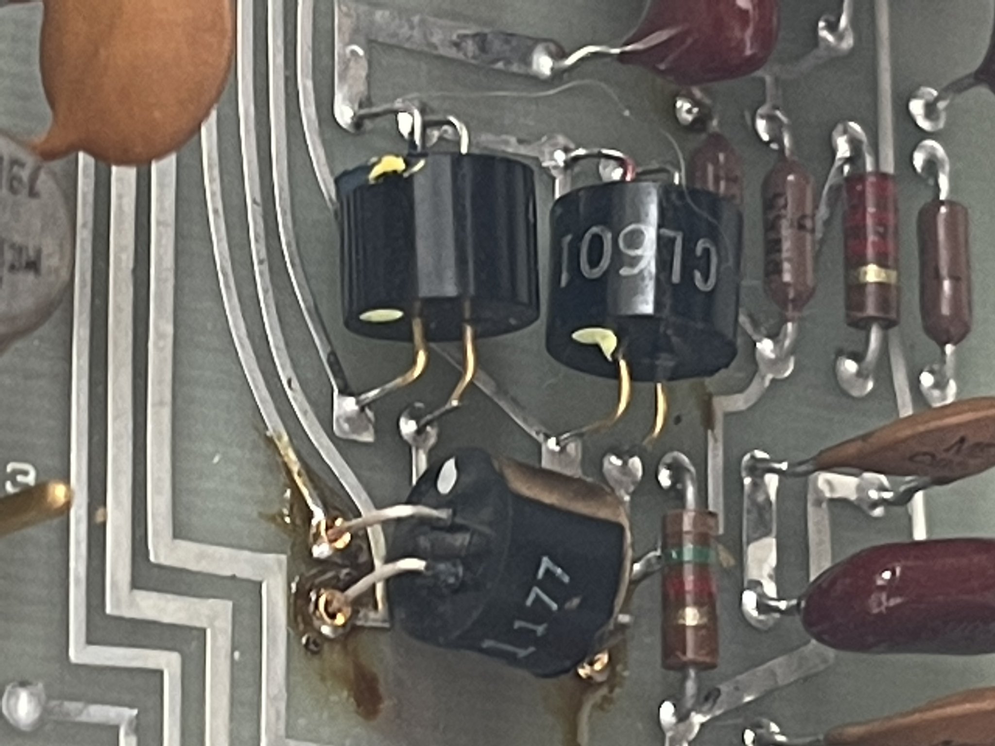

I am reviving this thread as I just recently reserviced my older ST1710A. It is very good machine however the photocouplers need replacement. The THD reading is sometimes unstable. I ran the generator onto my AP and the distortion is very good and stable, therefore m the problem resides in the analyzer.
It seems it uses is CL601. I looked on Google but I can’t even find anything. Do you know if this part can still be bad somehow or if there is a suitable replacement I can use?
Btw in the picture of my unit, it can be seen that U206 was replaced already at one point. So maybe the other one now is faulty.

I don't think you will improve it with newer LDR's and they are really hard to find. I would socket them. I did that on the one I had many years ago. It made selection much easier. You can use socket pins from an IC socket.

Yes it’s a great idea, it would be necessarily to socket U206 and the associated resistor R359 if I am hunting for a replacement.
Since you know how a fresh new unit performs, is the distortion measurement supposed to be perfectly stable or it also wiggles?
Also it is normal when I switch from fast to low distortion the needle jumps all to the right banging the needle against the end stop as the unit clicks waiting for the integrator and nulling circuit to stabilize? Or when I change frequency while in THD mode, same thing?
I usually avoid it by starting on VOLTS mode, wait for the unit to reach low distortion, then switch to THD.
