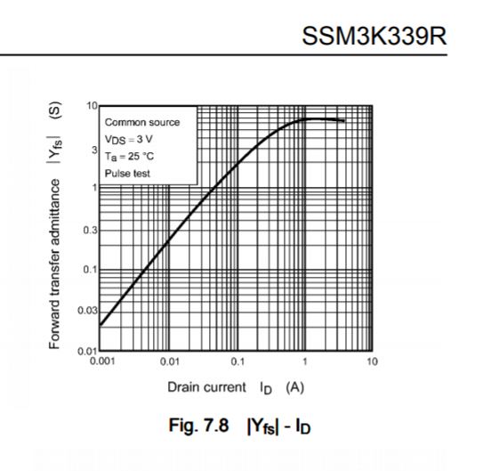

I advise you this mosfet. It has very high gm and perfect square law up to 10ma.
Unfortunately no spice model.

Thank you KlausB, it is indeed, also because I'd need two almost matched.

Hi Zintolo, example file attached. You have to edit the jfet (CTRL right click) to change "Prefix" from "JN" to "X", then change "Value" to the name of the model (NMOS_SSM3K339R) as it is a .subckt model. Note that this fet needs a positive bias voltage to conduct.
Thanks Tikiroo!
The new file is in attachment: 91 Wrms at 0,38% THD (3rd and 7th harmonics mainly).
