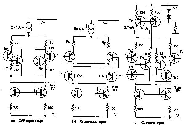

What about the topology at the lower right ?
From : http://peufeu.free.fr/audio/memory/memory-4-circuits.html

00940 said:What about the topology at the lower right ?
I use a variation of "D" where the cascode FETs are replaced by simple bjts.

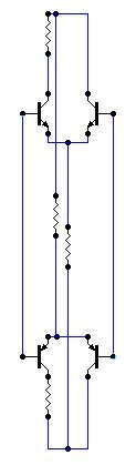

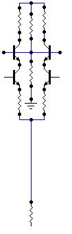

mr l said:here's some.
good to see your diagrams.
