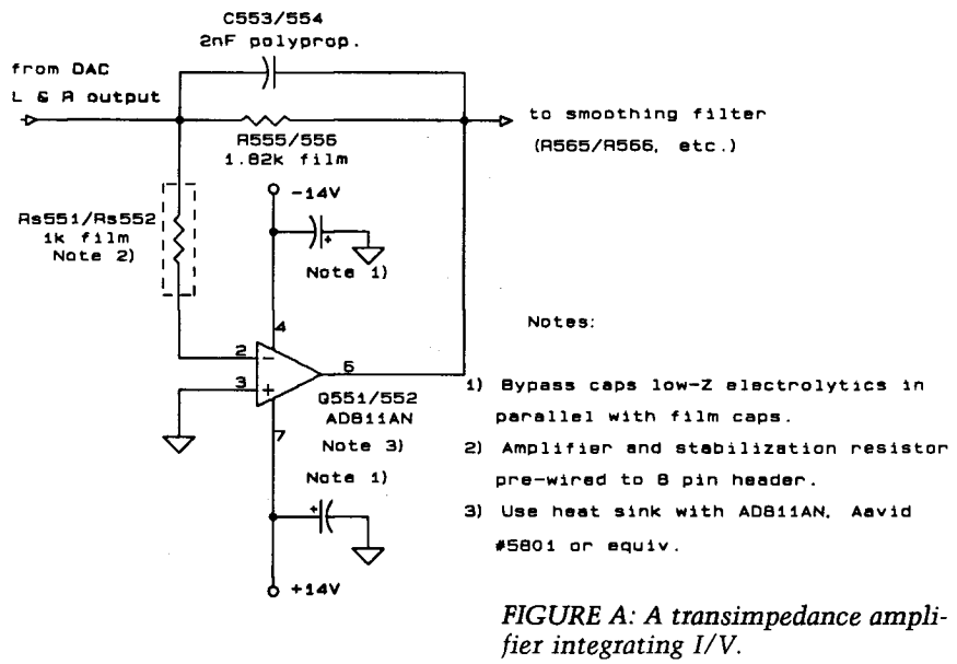

see attach, schematic by Walt JungNazar, if I have nothing better for I/U than THS3001 - how the schematic should look like?
What's the reason to use the provided schematic, if the current of the DAC isn't fed into the low impedance of the CFA? The 1K in series destroys the idea, in this case why not use just a resistor for I/U? It just a workaround to avoid oscillation with a cap in a feedback loop (whic is otherwise not acceptable for CFA), but a workaround which screws the goodies of the CFA applicaton in here...
filtering in first analog stage, good linearityWhat's the reason to use the provided schematic
resistor is inside feedback loop, dynamic impedanse of this design is 1.5ohm.The 1K in series destroys the idea,
