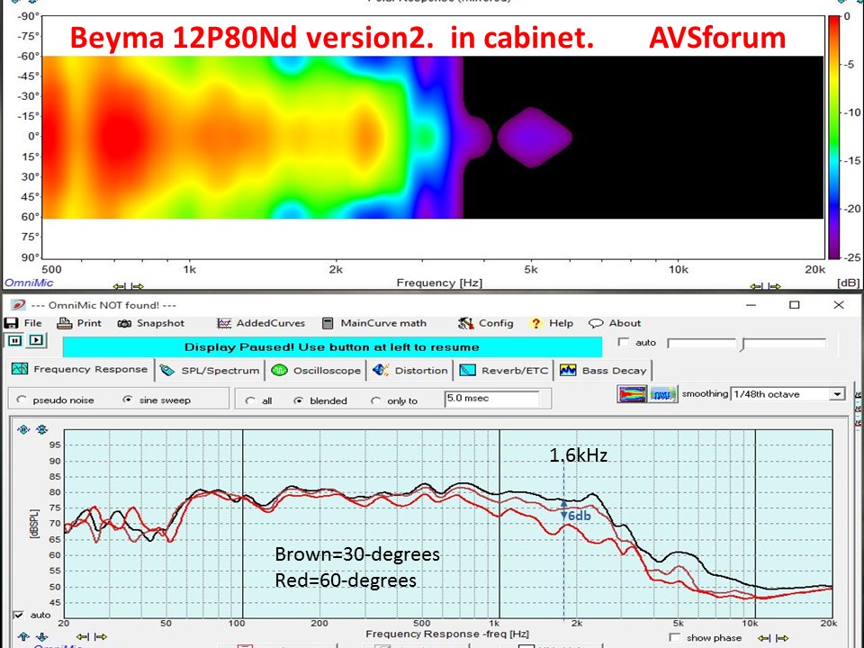

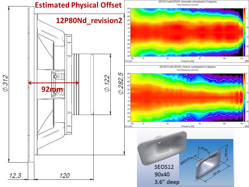

If you plan to use a passive crossover on the 12P80Nd, a horn with a similar physical offset could deliver improved transients with a "textbook" crossover circuit . From product documentation, the SEOS-12 has a similar physical offset with 90H x 40V polars.

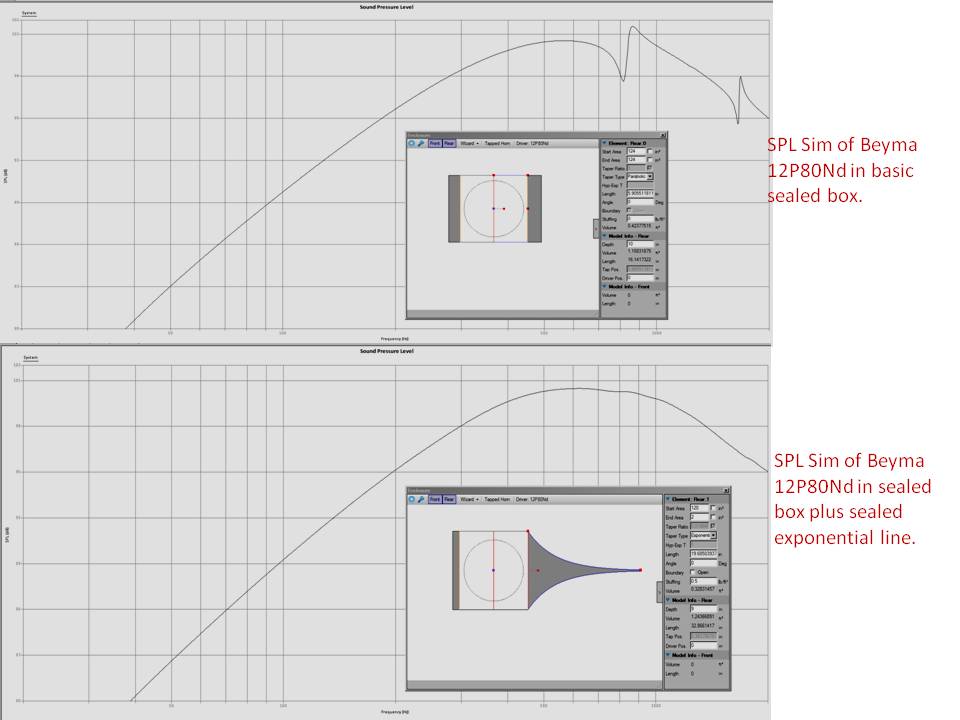

Measurements of the 12P80Nd suggest that a BW3 or LR4 crossover around 1,400Hz would have an 80-90 degree horizontal polar match. If you plan a sealed box, tapering the rear volume can reduce resonances. A sealed volume of 0.3-0.4cuft models a desirable Qtc ~0.55
For indoor use, a single 18" woofer, plus room gain effects, should produce acceptable 95db bass. For outdoor use, most simualtions show that dual 18" woofers are necessary to match the 95db efficiency of the 12P80Nd. Bi-Amping allows dumping hi-watts into a single woofer to match the 12P80Nd.

I think I am going with a 90 degree horn, Sones say that it is best when used outdoors and LineSource have shown that it is a good match to the 12p80ndv2´s polar respons in the expected cross over range.

The SEOS-12 looks very interesting, and I can understand that many have very god experience with it in somewhat similar designs. However, it seems to be out off stock everywhere :-(
Do you think the TD194 will do a similar good job? after all it must be designet to work well with the CD10nd
Can you try to run a simulation with the TD194 in that program you are using.
Also, I was actually thinking of a bass reflex design, but dos it give any real improvement in SPL when the box is not intended to go under 100hZ?
