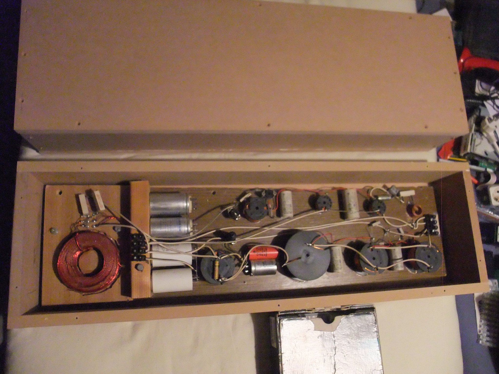

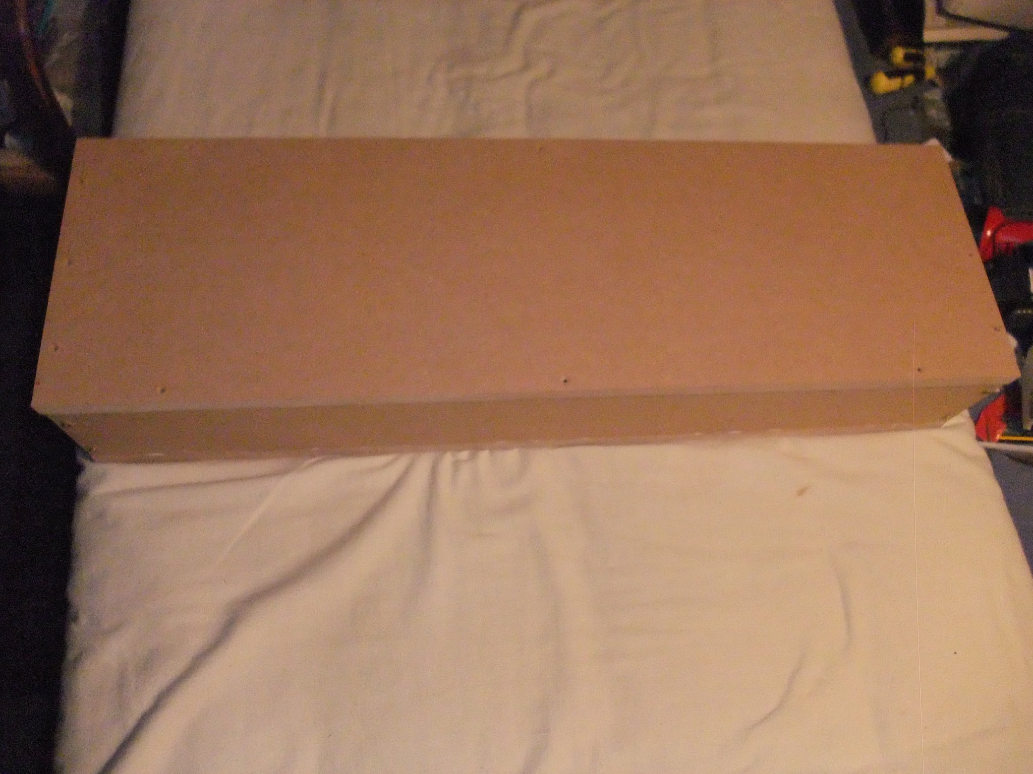

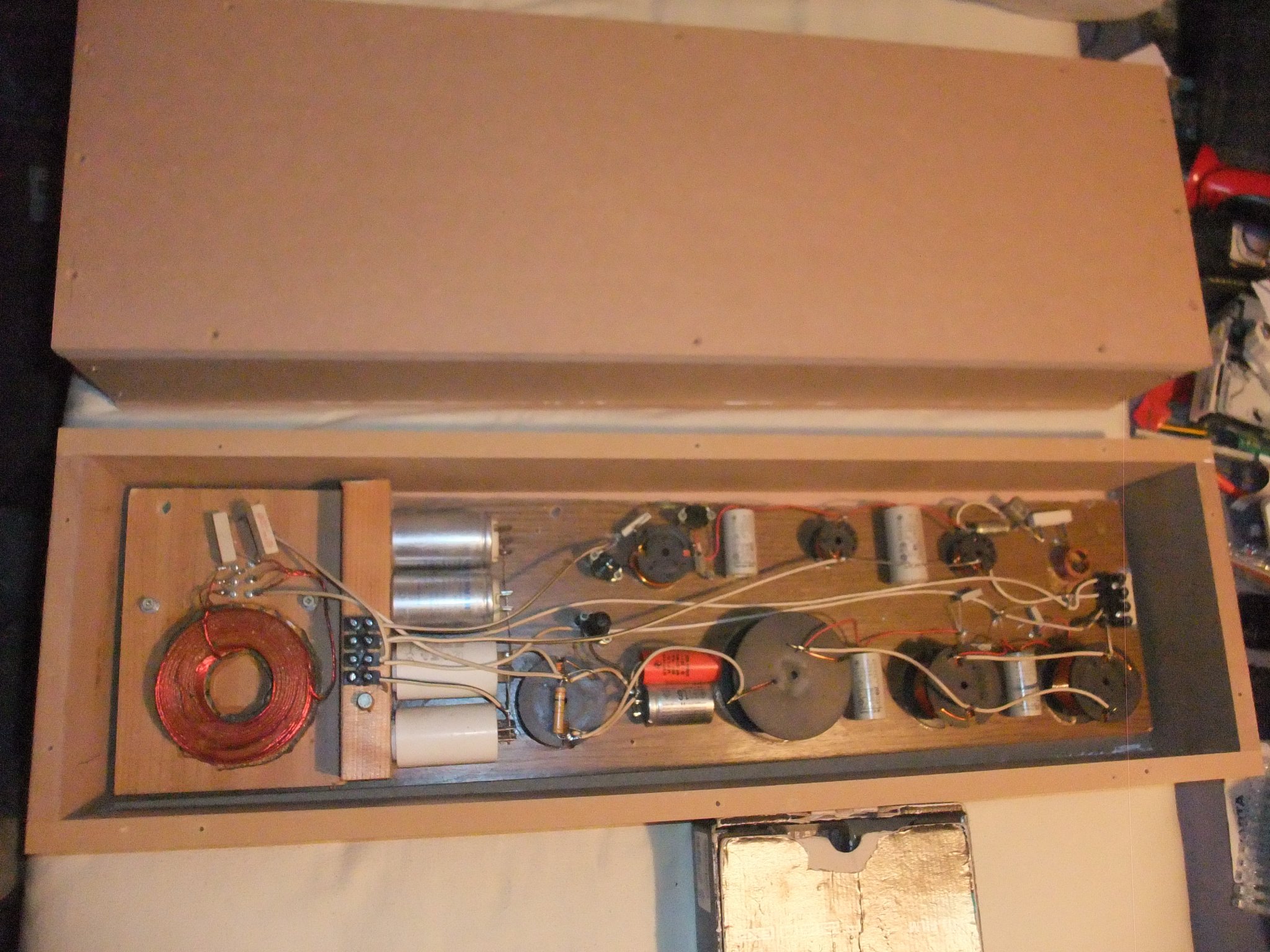

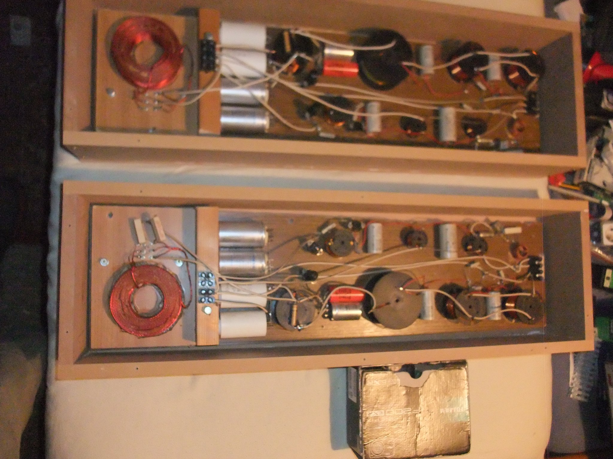

supplement to post #10: the main speakers from second image are the model Keilidh from Linn, but equipped with the Focal tweeter T120K and PHL-Audio B171 and working as sat-speakers with passive high pass (f3 approximately 70Hz, images I will upload next time). In this attachment the images of crossover network in an enclosure for the new apartment, in the old apartment (images post #11) both crossover network units were on a large MDF board (mounted on the wall) behind the backrest of the couch.
