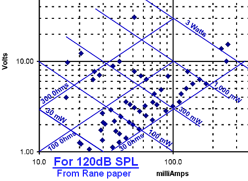

I once *designed* for 120dB SPL into "any" headphone. This was a Special for in-room recording monitoring of live bands. I expected to use >100dB SPL only a few seconds a night, but I wanted to know any distortion was the recording path, not the headphone amp. Insane for normal listening. (And yes, I've gone deaf, though not from that amp.)
My survey led to 7Vrms behind 29 Ohms.
Agreed that 114dB SPL is ample for any non-insane purpose. Which leads to 3.5Vrms or 5V peak. Using available +/-8V supplies allow for high-drop buffers (Darlingtons). And at some point you have to let the User decide his own self-abuse (but you also put a warning in the manual!).
The 29 Ohms semi-equalizes power between low-Z and hi-Z phones. (The hi-Z typically need less power.) It also cuts-down idle hiss in 32r and down (IEMs). And is cheap protection for the amplifier (shorts happen).
> 29 ohms seems lower
That's a large-signal impedance, to taper max power over the wide range of impedances.
Small signal impedance may be different if you show that a given headphone gives a nicer response that way.

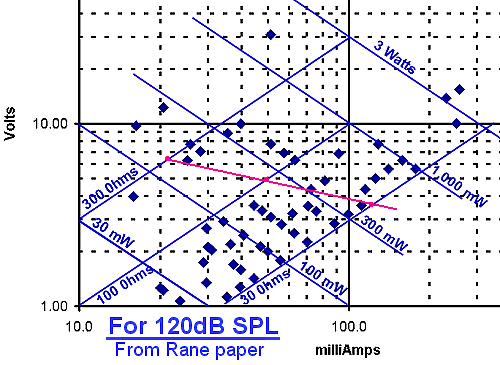

Roughly it tapers from 200mA @ 300r to 400mW @ 30r, reflecting the fact that most hi-Z designs are also efficient, and 7Vrms in 32r is way more power than we could want.
It's been over a decade since I had this spreadsheet. Now looking again, it appears that 7Vrms behind 29r will not drive ALL headphones to 120dB SPL, though the ones out at the 3 Watt line were "special" and not something for portable gigs. (Also "all" these models are discontinued, but the physics set some limits that do not change.)
Just as a side note, 29 ohms outside the feedback loop is not something I'd consider generally acceptable... some IEMs will show an appreciable frequency response deviation even at 1 ohms (and, I imagine, may be tuned to specific nonzero output impedances in some cases), and even the world of full-size headphones is anything but exempt from this kind of shenanigans, e.g. the trusty Sennheiser HD558/598 should ideally be seeing around 10 ohms at the very most, and that's for a 1 dB deviation threshold (still perceptible but not dramatic terrain, possibly still too high for perfectionists).
The large-signal resistance can be inside the NFB, even put in the collectors of a p-p emitter follower.
Without it, an amp which is Loud Enough at 600 Ohms *may* at 32 Ohms blow your brains out too easily.
