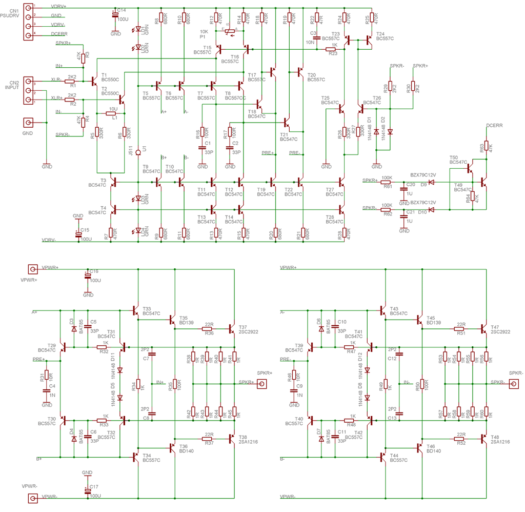

The Marsh headphone-amp is a Class-A/B output stage (see attached topology schematic from the article abstract), the circuit values might have to be adjusted to "crank-up" the standing bias current. In my own experiences with my HiFiMan HE-6's, I've found that we really need about 200mA bias-current in a Class-A/B output-stage to make the planar-magnetics really "come into their own" from a sonics standpoint. 😎
the HE-5LE are way low sensitivity @87.5 dB/mW compared to say Grado 32 Ohm headphones @ 98 dB/mW and requires more current and V to reach the same SPL as typical near 100 dB/mW headphones - >10x more power
As I mentioned, I haven't had an opportunity to read Richard Marsh's article on his headphone-amplifier in Linear Audio, but I would assume if we run with at least +/- 24VDC power-supply rails and 200mA bias-current in the output stage, we should be in good shape for driving the HiFiMan beasties (Richard noted that he himself uses this circuit with HiFiMan planar-dynamics...). 😀

Richard,
Thanks for the information. So, about 180mA of current delivered into a 32-ohm load or just a tick over 1W of Class-A power before transitioning into Class-A/B operation. That should be head-pounding SPL's while staying in Class-A operation! 😀
Excellent! 😎

Search DIYaudio and Google for ExtremeA a balanced ClassA amp.
Consider building a balanced Class_A amp like the "ExtremeA" that can easily drive balanced headphones like the HiFiMan or modest power demand speakers.
If you are not using battery power, it seems smart to build ONE balanced DIY amp that can be used with both headphones and speakers. YEP... about 20 pounds with 10 watts of ClassA power.... HOT HOT HOT... ''Till death do us part" Give it to your kids
It is possible to use dual JFETs for the ExtremeA input stage instead of bipolar transistors in the schematic if you have a funky audio source with irratic output impedance.
