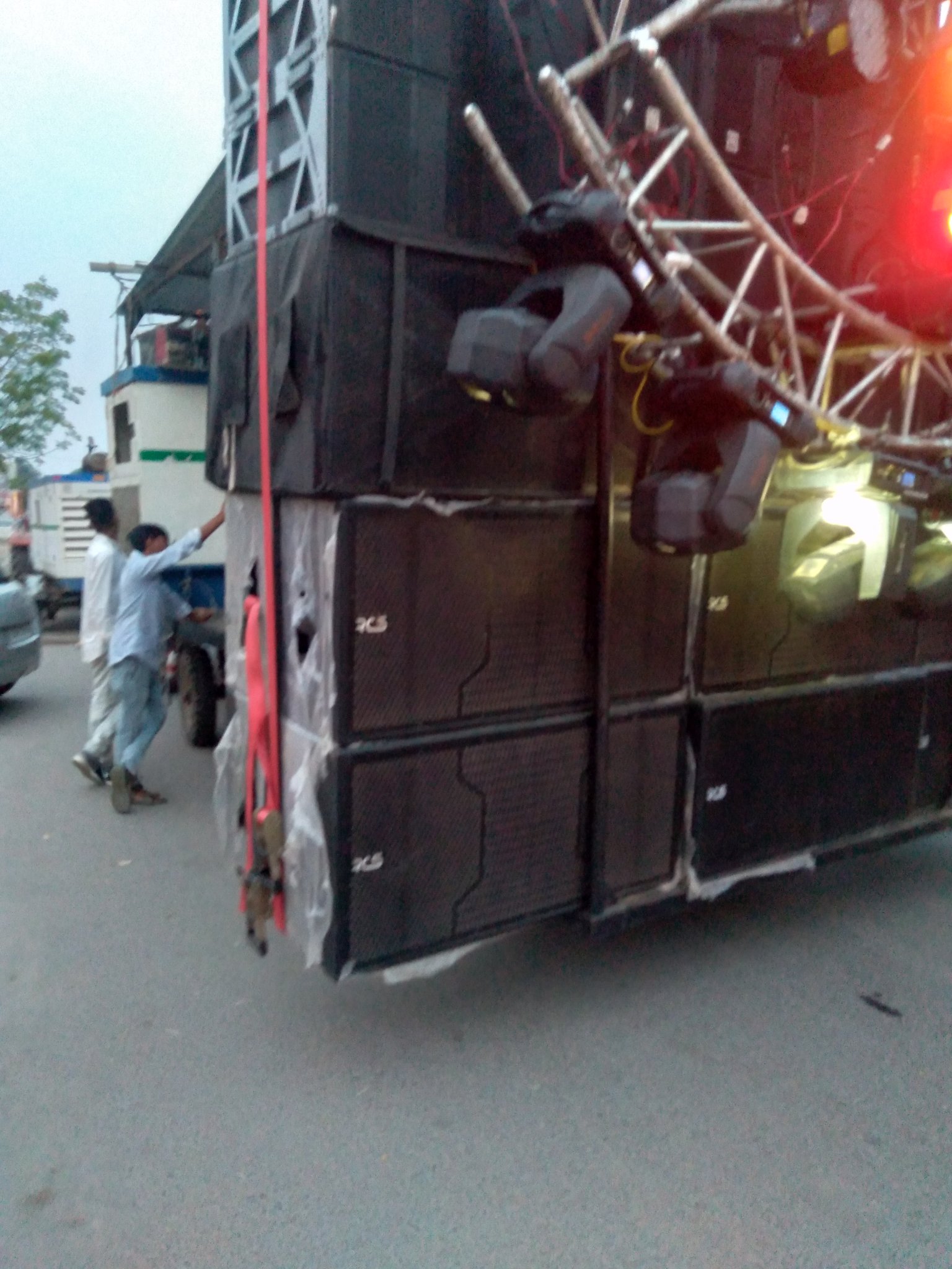

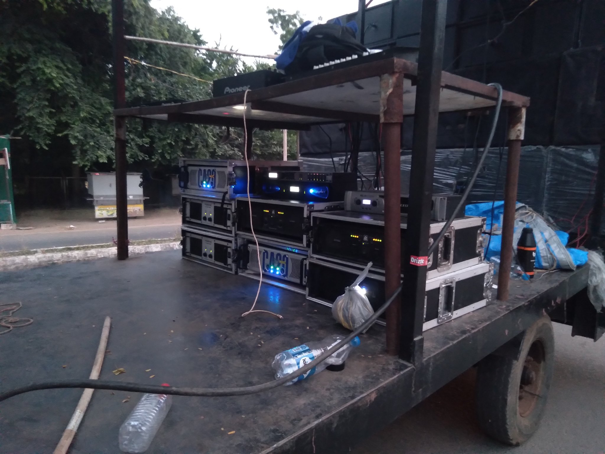

I will post a photo later, 15 - 25 kVA generator driving 7 amplifiers, each the size of a computer case, and many speakers, on a farm tractor trailer, flashing lights too.
Thumping bass, screechy treble, enough to give you a body massage, and things to fall of your car dash top, if you are close.
Fidelity, in such conditions, is not expected.
The amps used here are Mosfet units, with SMPS, no effect from minor input frequency variations, and now mostly FM modules with USB stick as storage, to play recorded music.

As promised, photos of what is used here...a sample, really.
