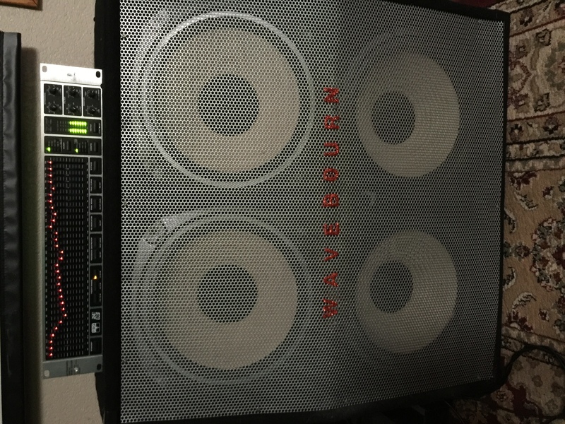

The Eminence Beta 12lta gets my vote, as I have built a pair in sealed and stuffed 2.2 cu.ft. cabinets, driven by a cheap Sure 20-watt per side class-D amp with a miniDSP 31-band EQ. I've been enjoying them for a few years now. I posted pictures here somewhere.
