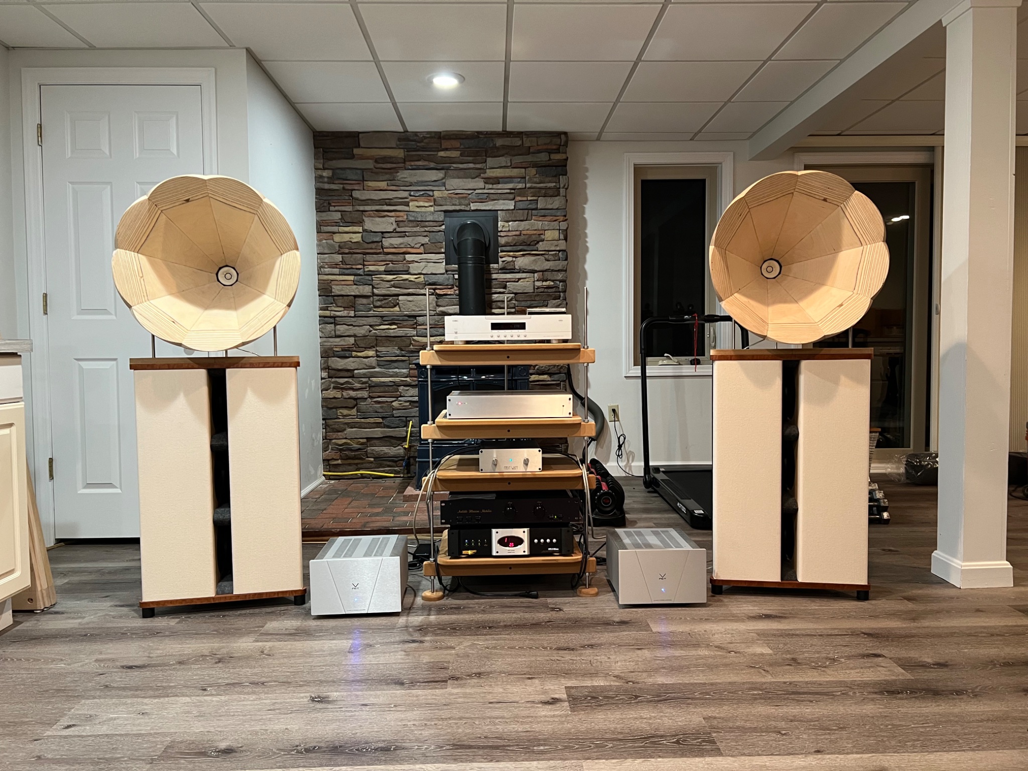

I recently picked up a pair of used Fostex 108ez and threw them onto some wooden conical petal horns with no back chamber. They astounded me with their imaging and sound stage. I heard things on recordings I never heard before.
I've got to try this. Picture/dimensions please!

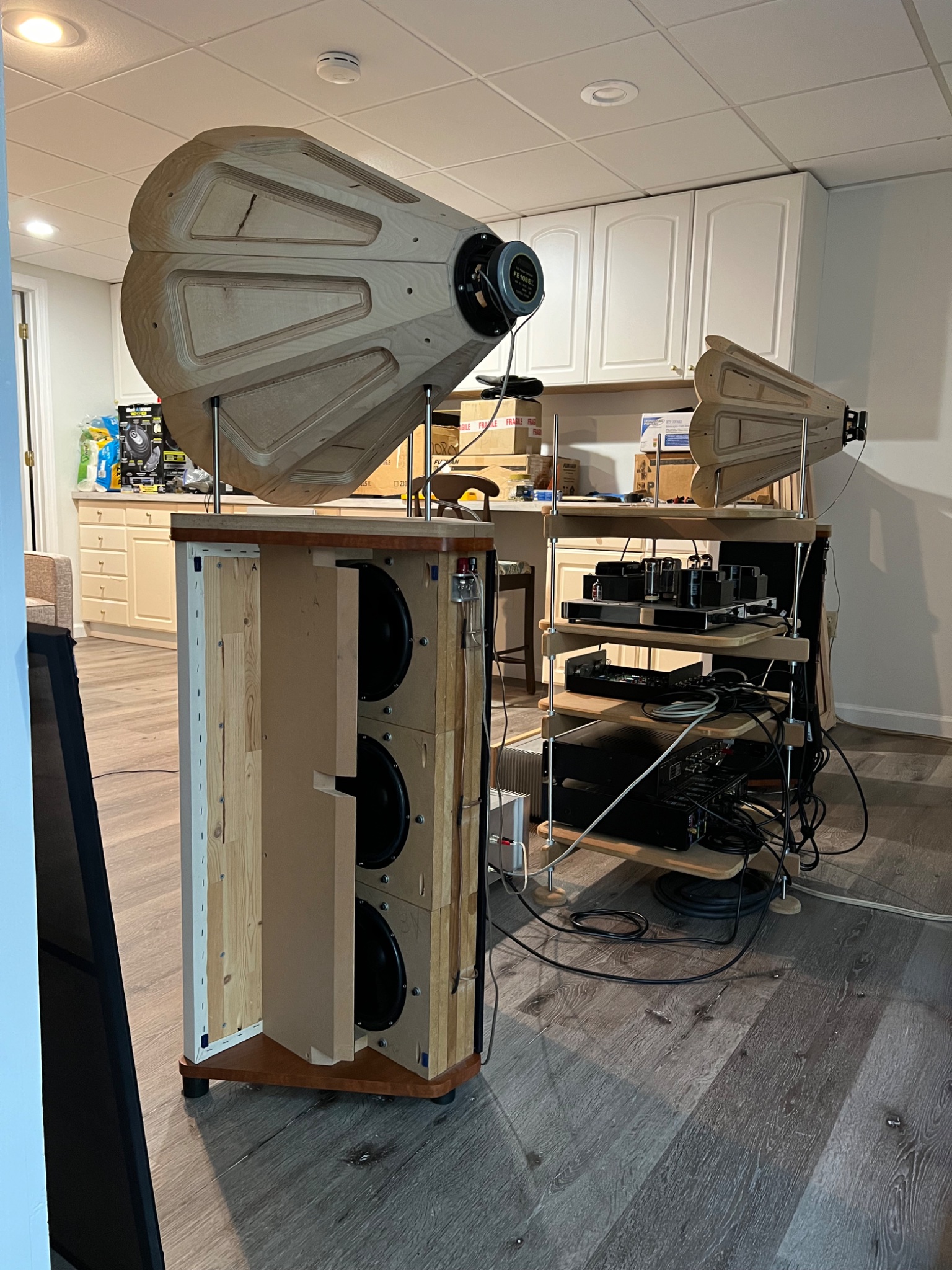

I don’t have the dimensions handy…posted them in another thread about horns and slot loaded bass at one point I think.
I’m not completely satisfied with the slot loaded bass panels. I think a driver with more xmax and a more powerful magnet is needed… each panel uses (6) 8” buyout peerless drivers. Not sure I want to go back into it again. Tried extending the panels back and it improved a bit. I’ve also added a pair of Fostex T90A and they greatly improved detail and overall balance.
Thanks, I reckoned the translucent floral cone too fragile to push hard OB so the front horn would be of great help, even if it didn't boost above 7khz. I have some drivers stashed away for SLOBs but not enough time to build. For apartment-use variations of push-pull OB (like Celestion SL6000) worked better than I expected, just no deep bass.

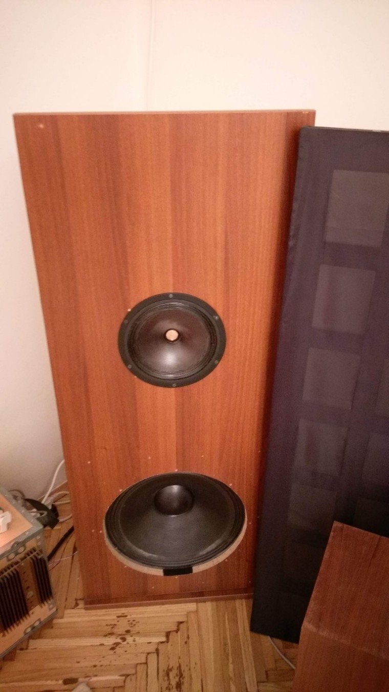

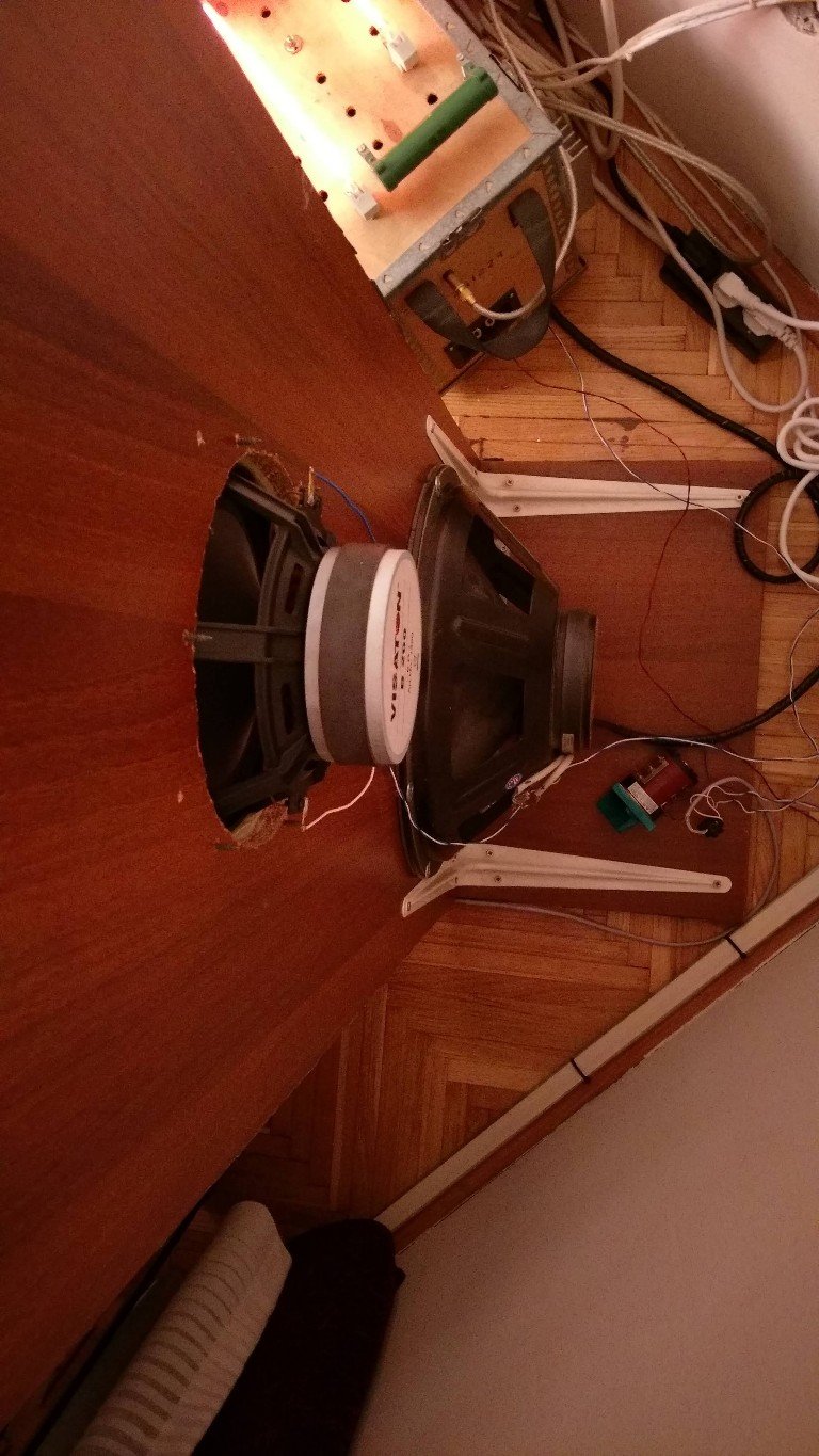

Modifed Visaton B200, fed by a transconductance amp (Pass F2). With the woofer, (Beta 15) of course. Biamped.
Not probably the absolute best, but I was quite happy with it, until I had to dismantle/abandon it (for entirely other reasons)...

@Vix I've listened to the B200. An outstanding driver... just not built of paper. 😎
