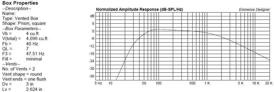

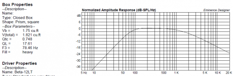

Whoaaaah, 50 to 10k?!?
A cheap option might be the Beta12LT!
Speaker Detail | Eminence Speaker
High eff, wiiiiiide band! 12"
Gets down to 50 in their 4cuft vented cab:
View attachment Beta_12LTA_cab.pdf
And 4cuft isn't that big if you consider it a "stand" to get the driver up to ear height! ;-)
The 1.75 sealed looks pretty sweet but rolls off at 80Hz but it's only 9dB down at 50

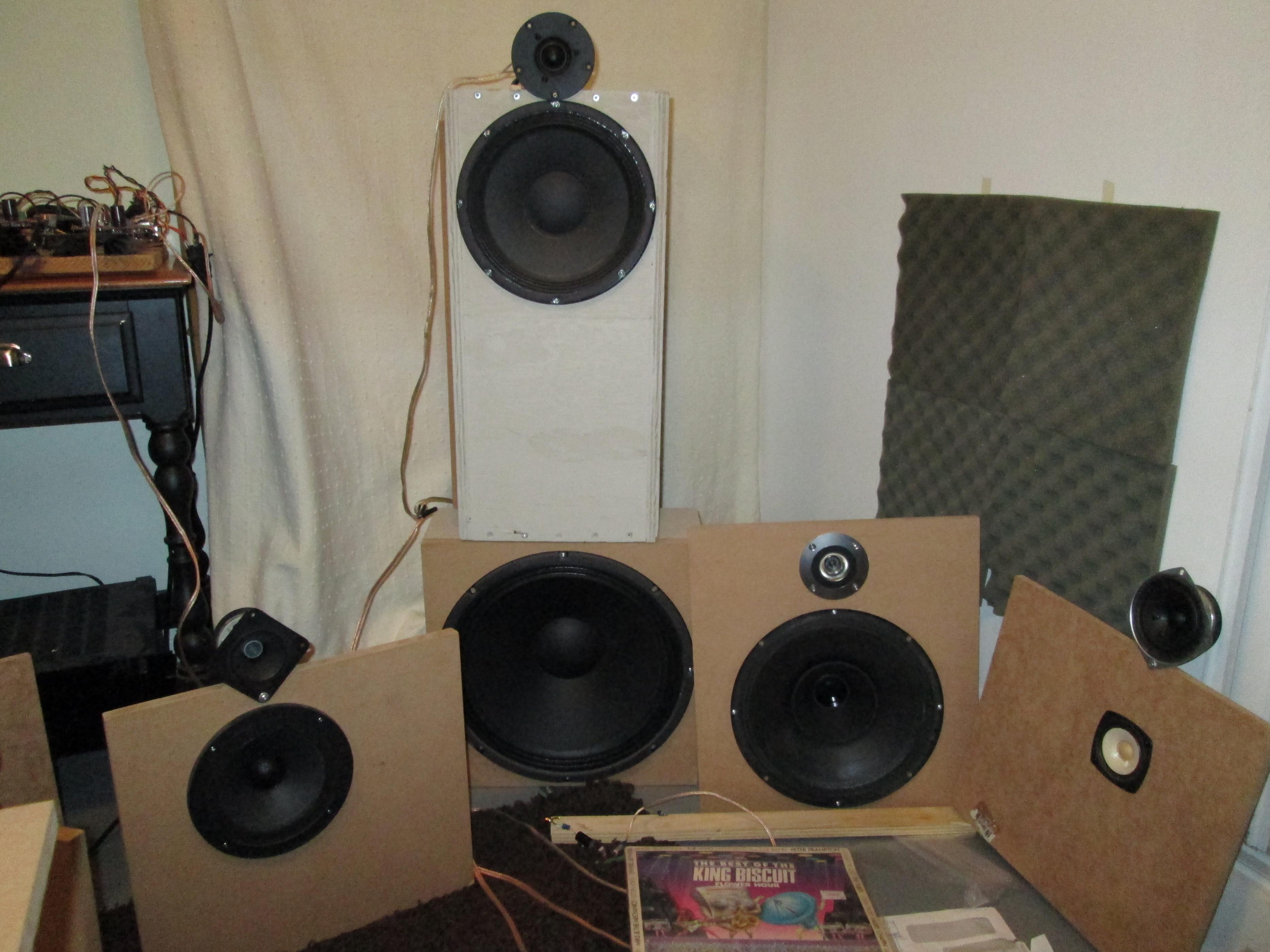

Godzilla's fallen in love with his and it's big enough to get close to 50Hz. There's a notch filter for the stock driver but apparently replacing the dustcap with a phase plug helps. (.. almost there myself, just have to find something to work as a plug ... hmmmm ... 1/2 a Kinder Egg! No, ... it'll melt ...)
Here's me playin' with mine open-baffle style!
Do the usual tricks to deal with the cheap stamped metal frame and other issues: baffle and/or magnet mount, notch filter, putty/deaded basket, phase plug, breakup back-of-driver to basket reflection, 99cent trick, painting whizzer, ... , ... , adding spokes to the driver, ..., ..., madness!

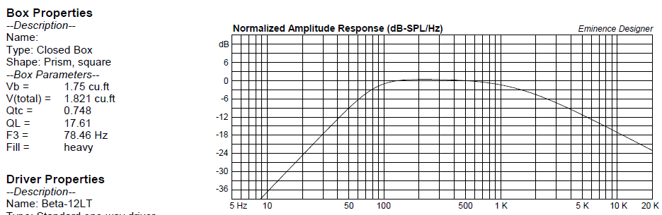

Jeff
PS I think there are other less expensive 'pro' options too! I recall the Legend12 or some other guitar speaker being used as a fullrange.
