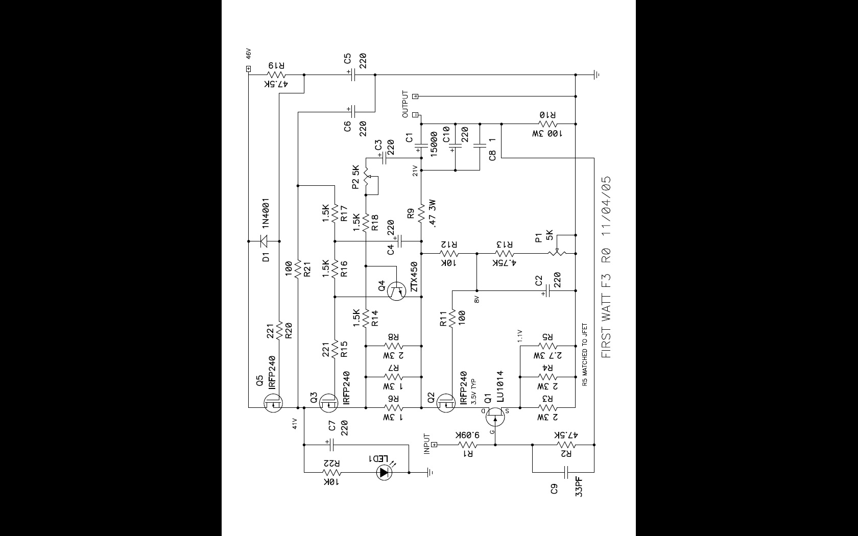

@ 15 watts into 8r could I not at a later date, add as above states, a F4 or 2 to a F3 if I wanted more volume to drive a wider range of speakers. ?
It's been 6 months but I finally put the parts togeather for an f5. The case should be here tomorrow, and matched jfets from Hong Kong should be here in a week or two. Do the MOSFETs need to be matched? I only have 4 of each, so I hope not.
As far as I understand you don't need to have matched output mosfets for F5.

Wow, I'm already on my second firstwatt amplifier, the F2. I bought PD's boards and stuffed both channels before I realised Cviller's F5 psu board can't be rejiggered to output dual +24 supplies that the F2 needs.
Luckily I bought PD's PSU boards, and my plan is to use these boards for both the F2 and F5 with jumpers to switch between dual +24 and +/-24. However, I noticed the F2 PSU schematic uses 1 ohm resistors whereas the F5 uses .47 ohm. Are these values critical, or are either fine for both amplifiers?

I would choose any SemiSouth enhanced product over an F3 personally. The F3 maybe to SET sound for me or something. I did not like it. The F2J has punch, and a 'cleaner sound' than default F2. I've been listening to the F2J in OB into a lowther, and it's closer than you think to the F5, good sense of atmosphere. It doesn't have the dynamic punch of F5, but you may not need that in OB. If you didn't have F5 to compare it to you may not know. You can get the F2j to sound differently by changing the source resistance a bit, gate resistors etc. Of course a current type compensation across the terminals helps a bit, and can change the sound of F2.
