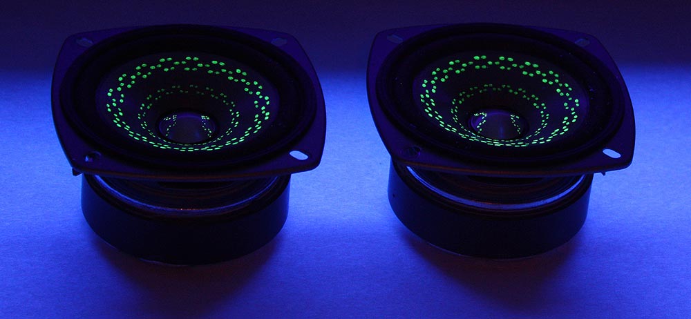

Now, all you need is a tweeter 🙂
The midTweeter (that ¾” dome in the middle) is very good at the top and better than some very pricey tweeters. And no XO to get in the way which gives them a big advantage.
This a glow in the dark set of FF85wKeN
dave

Dave, it's always been your opinion that highs from midtweeter are better than highs from pricey tweeter.The midTweeter (that ¾” dome in the middle) is very good at the top and better than some very pricey tweeters. And no XO to get in the way which gives them a big advantage.
dave
But listening tests and measurements clearly dispute that.
