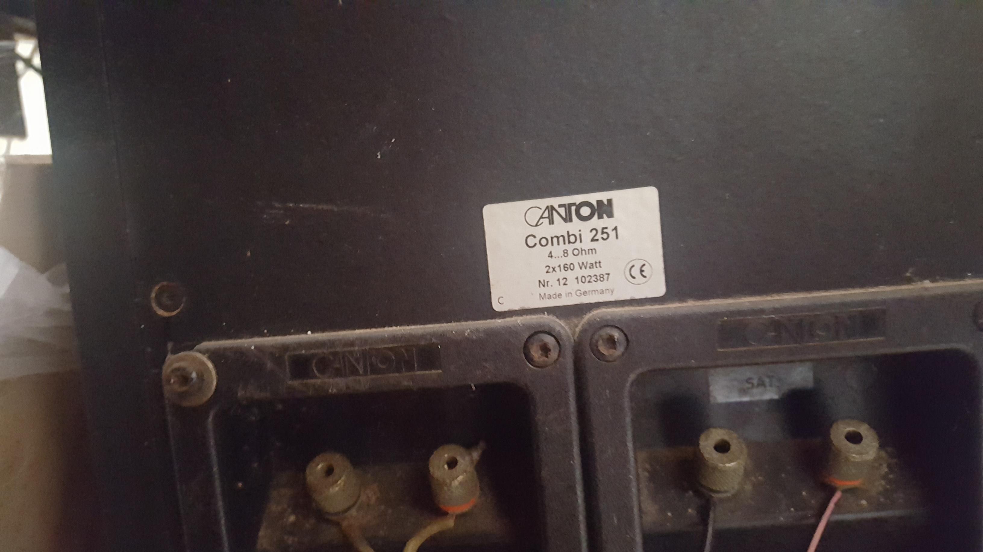

One fine day, came across an old passive subwoofer with 6" driver.
It was a Canton Combi 251 subwoofer.
With some diy knowledge connected the passive sub to the 8w amp.
The fostex 206en in the double bass reflex boxes were connected as satellights.
OMG

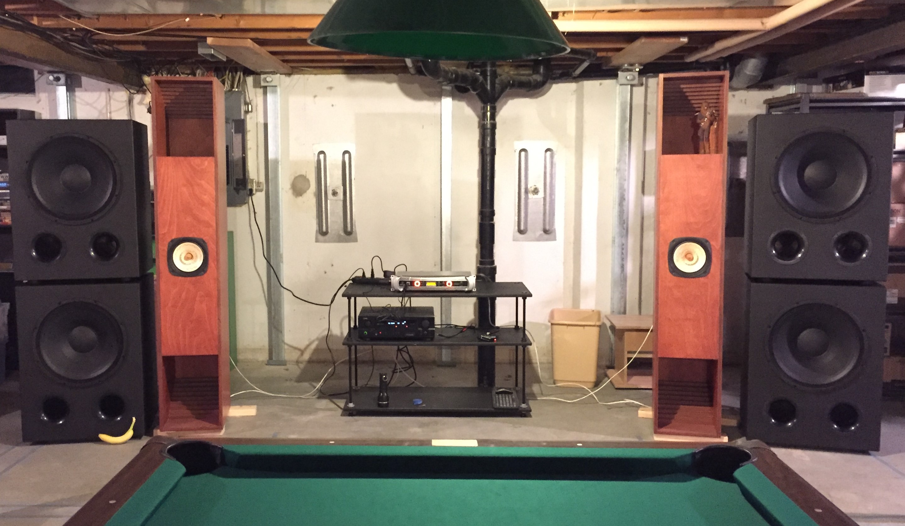

I am a bit late to this one...
About 9 years ago I built a pair of Kirishima's that use a pair of Dave's enabled drivers. They have been in a few different systems but I have always enjoyed listening to them.
Here is the "lowest-fi" setup that they have been in. It was also one of the most fun setups for them though with the addition of the bass cabinets. The banana is included for scale.
Wow!
Kirishimas are flanked by four 18" powered subs.
Never too much for the capabilities of the 206e.
Enough for a rock concert!!
