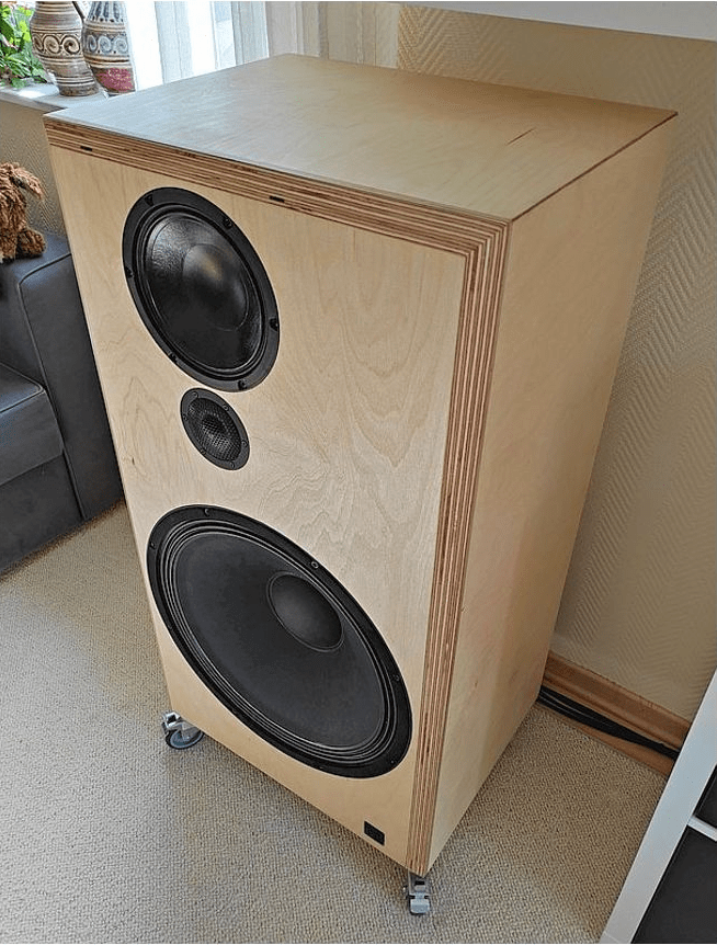

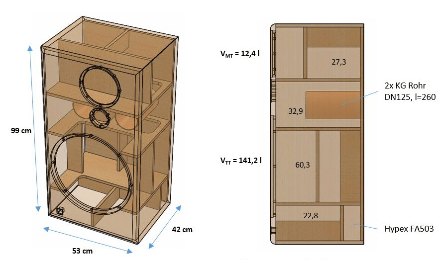

I have used the 18FH500-8 as woofer in a three way, ~140l vented:
Worked pretty well, started with ~30 Hz tuning that was too low, sounded a bit stuck with low airflow at the ports. It came then well alive with a higher tuning 35-36 Hz, ports blowing now happily. The 140Hz is borderline, would I build it again I'll give it ~160-170l.

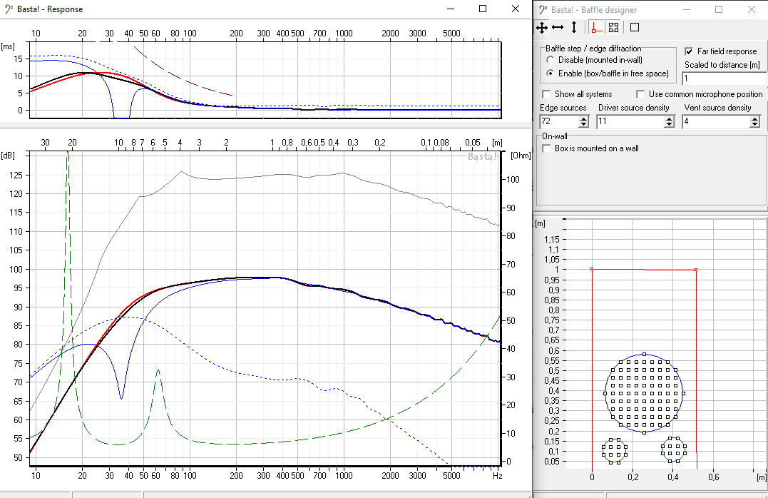

Here is the correspondent Basta simulation incl. Baffle Step:
Black curve is with 140l, red one with 165l (30% stuffing with damping material considered). Nice low group delay and slowly sloping response gives dry and precise bass. SPL limit was my ~40m² room, everything in the interior started rattling when the woofer was still doing only few millimeters of excursion. Had a DSP in my system, but there was no need for any low frequency equalization.

Nice build!I have used the 18FH500-8 as woofer in a three way, ~140l vented:
View attachment 1262225 View attachment 1262226
How come your model doesn't match your build?
Your model shows two 5" ports at the BASE of the enclosure.
Your build shows the 2 ports above the driver.
Why do you need higher air speed for the enclosure to sound good?
The question is, why did produced low air speed with the lower Fb. Maybe because the box is undersized/borderline? Just thinking.Why do you need higher air speed for the enclosure to sound good?
