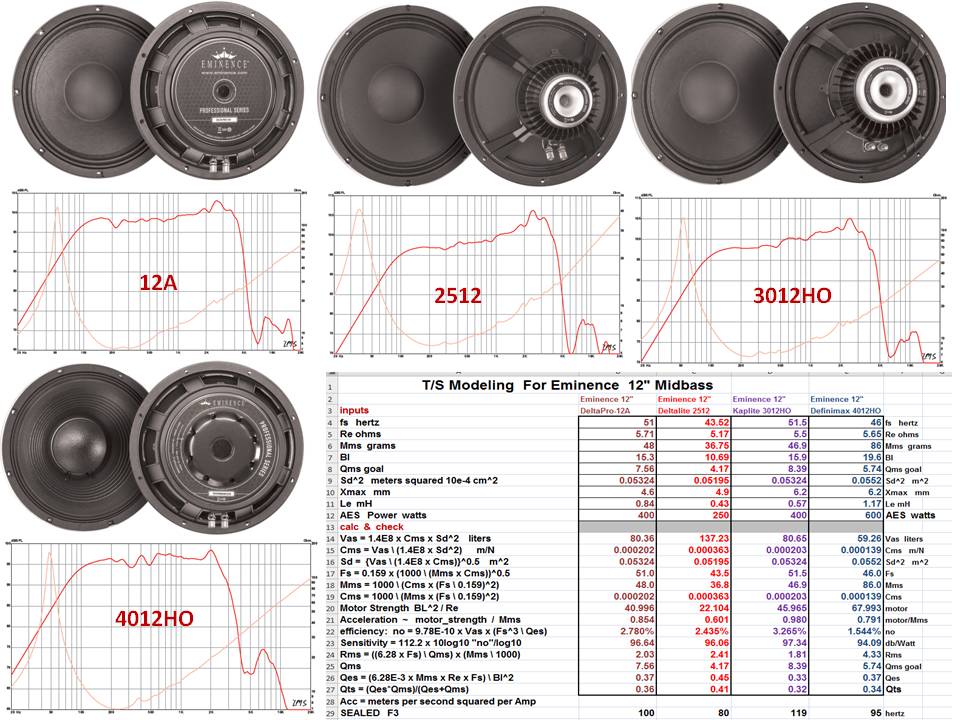

Best Eminence 12" woofer for a sealed SEOS Speaker
Summary slide.... might help others with future Eminence selection decision.
For a modest volume studio room, sound quality is more important than Max SPL.
For an SEOS12 tweeter, clean high frequency SPL extension over 2Khz is important.

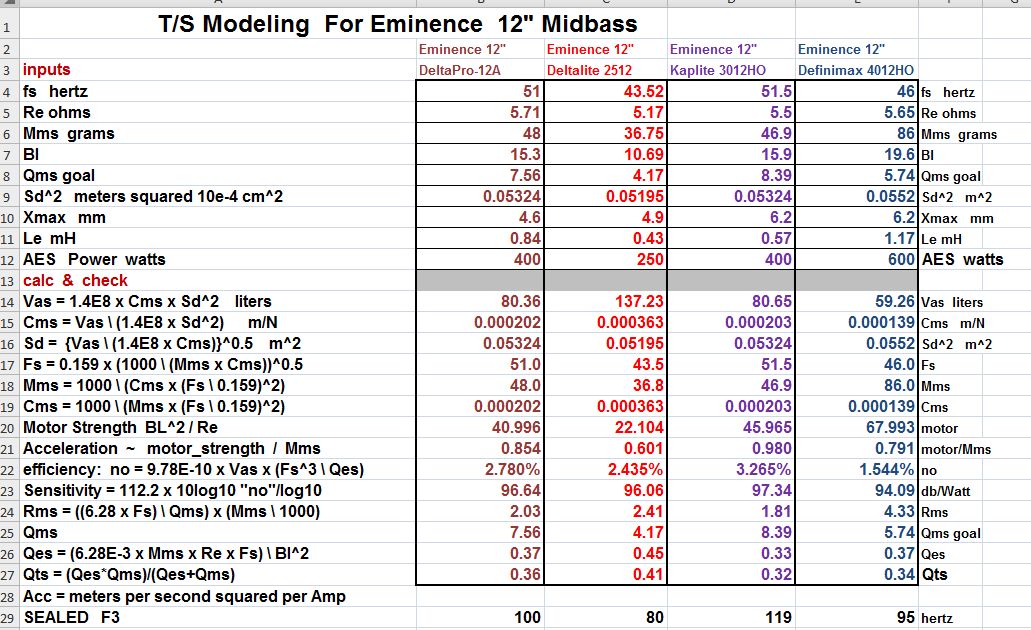

Sealed F3=80Hz. The 4.8mm Xmax, smaller gauage 250W voice coil wire on DeltaliteII 2512, plus conductivity of NdFeB magnet keeps Le=0.43mH with good high frequency extension. Rising SPL above 1Khz complicates Xover.
Sealed F3=100Hz. The Delta Pro 12A reduces Mms to 48 grams with a modest 4.9mm Xmax, Le=0.57 from inside/outside voicecoil winding helps smooth frequency extension and simplify Xover.
The Definimax 4012HO is a good canidate for inductance reducing shorting rings on the pole steel because of the high 1.17mH inductance created by the long, heavy copper voice coil requried for Xmax=6.2mm at 600watts. The 86g Mms also limits high frequency.

You are forgetting that all 12inch cones including
the Definimax have narrowing response on axis.
Its a simple fact of that cone width.
Rising SPL does not complicate crossover. Its just
as fair to say the definimax has drooping SPL off-
axis as suggesting the weight helps it remain flat.
Either way does not mean your can extend the
crossover point above what is right for 12" and
still expect uniform coverage. You cross under
or at that point, there is not so much difference.
You take any of the "risers", and allow the baffle
to obscure the right and left edges. Dispersion to
a higher frequency will flatten them out.
Go survey some Faital and Selenium 12" spec sheets.
Not cause of anything wrong with Eminence, just because
those other brands show both on-axis and 45deg off axis.
What you discover is that all 12" cones will sound different
on-axis vs off-axis beginning gradually around 900Hz.
So any 12" (including Eminence) would properly cross to
SEOS at or not much above that frequency.
Lets say your SEOS won't go that low, probably doesn't.
What can you do to make this work? You make the 12"
speaker less wide by covering the edges. Just like what
is often seen in midbass horns, only without the horn.
With an opening 10" wide, you get even dispersion to
1200Hz, at expense of losing some rising response.
With an opening 8" wide, you get even dispersion to
1800Hz, at even more expense of rising response.
Of course it takes a 12" woofer with rising response
to be able to make this trade-off. If already rolled off
flat with mass, then you got drooping response both
on axis and 45 degrees, once you spread it out.
I'm not going to suggest narrower than 8", cause
probably not any 12" with enough rise to do that.
And tuned cavity in front may become obnoxious.
Farfalle. Is that better than straight edges,
or just JBL being unique for pasta sake?
RJ and Karlson had even weirder apertures.
Not trying to disperse 12" full range, just
trying to meet up with a SEOS. You would
definitely not fail by cloning JBL's aperture.
But are straight edges really all that bad?

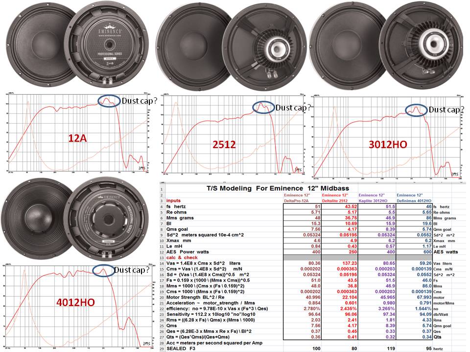

Would removing the dust cap reduce the peak?
I bet it will reduce the peak!
