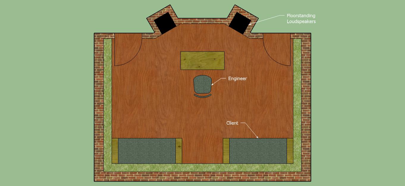

I'm building a new studio for myself - I work in the music business... (approximately). I've had built a 4Pi and an Econowave... both to my satisfaction... but I know little about the science...
The new system will be externally crossed over with a 2 x 6 DSP unit, and tri-amplified.

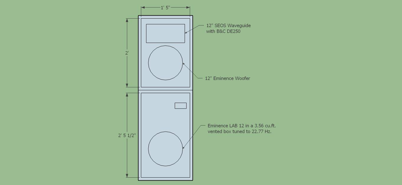

Eminence speakers are available very inexpensively, where I'm at... I want to find the best 12" woofer to put in a sealed cabinet, crossed over around 1.2 KHz to a CD in a 12" SEOS waveguide... a fair bit of real estate is available... so I'm trying to stick with WinISD's default cabinet recommendations, being that it surely knows more than I do, about cabinet optimization.

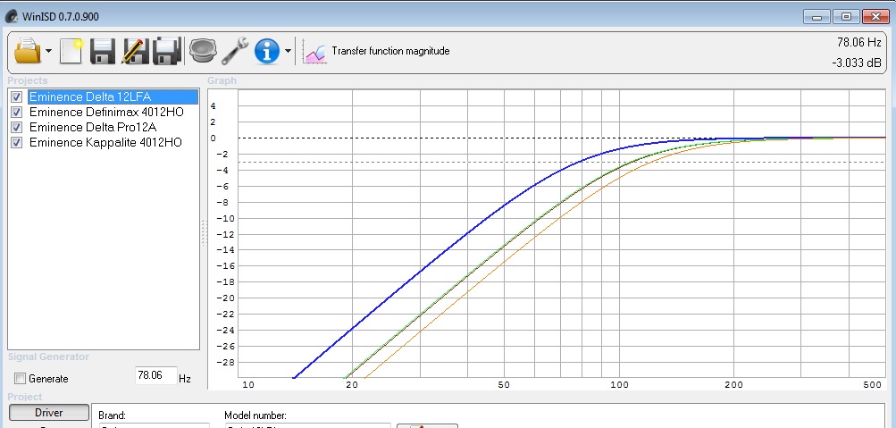

I modeled every 12" speaker that the Eminence website recommends for sealed boxes, and the Delta 12LFA came through, by far the best -> -3 dB @ 80 Hz in the recommended enclosure (2 cu. ft.)... Attached, you can see simulations of the other Eminence drivers popular with the SEOS guys - the Delta Pro-12A and the Definimax 4012HO - neither models as well as the Delta 12LFA...
So whats not to like about the Delta 12LFA - why is it so suspiciously cheap ($90)? Why should I consider the Delta Pro-12A ($135) or the Definimax 4012HO ($215) over the Delta 12LFA? I'm certainly not trying to scrimp on this expense - I'm going to be spending a lot of time on these...

Why are the other Eminence drivers more expensive than the one
that measures the best, as far as LF extension is concerned?
Definimax is obviously more expensive for the higher power handling
capability, greater Xmax, shorting rings in the motor (less distortion).
Delta 12LFA has pressed steel, weaker motor, less smooth response.
Delta PRO 12A seems the best overall choice for your needs. Smoother
response with better HF behavior. Qts is lower because of the stronger
motor.
Study the SPL/freq curve and any distortion measurements you can find with careful consideration to your studio application. Many Eminence 12" speakers are designed for guitar and bass-guitar applications where a rising high frequency SPL provides a desirable "timbre". Piercing for lead guitar or the 5th string on a bass-guitar. ALSO, in a studio you can favor sound quality over max SPL. i.e. A lower Mms from modest Xmax (like 4.8mm) . Building a slightly larger than spec box volume offers Qtc and stuffing tuning options.
Take a close look at:
The Delta Pro 12A reduces Mms to 48 grams with a shorter 4.9mm Xmax as a tech to smoothly extended frequency. F3~100Hz in 1cuft sealed. Designed for PA. Probably the easiest Xover design. Probably best choice if 100Hz F3 works.
The Deltalite-II 2512 Neo-motor reduces Le~0.5mH and with Mms~37 to get good high frequency extension but has some >1Khz peaking. F3~85Hz in 2cuft sealed makes it very popular for HT. Lower F3, but >1Khz peaking needs Xover attention.
Given that your low end is covered by the Vented Lab12,
I would put Kappalite 3012HO in the 2CuFt sealed box.
