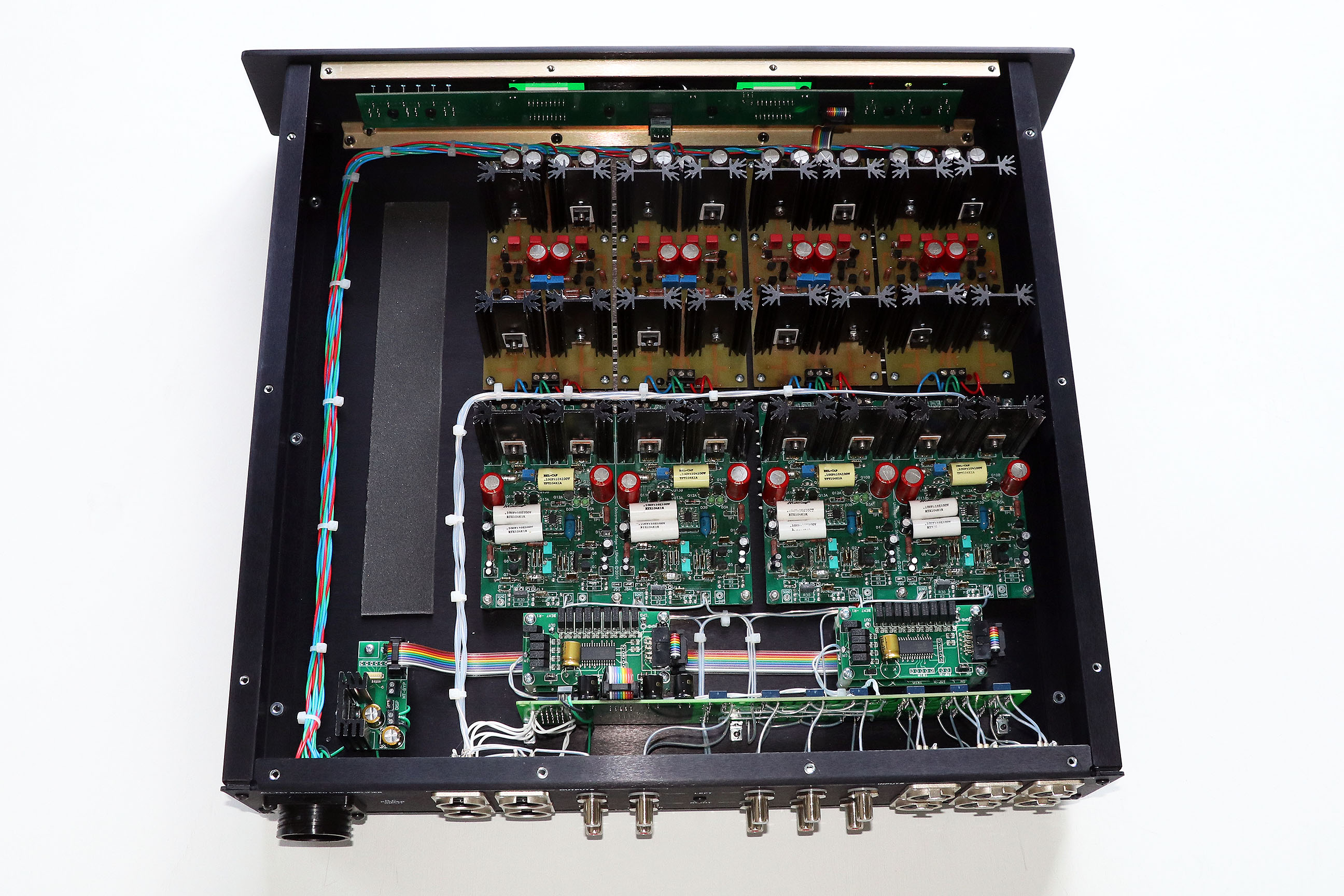

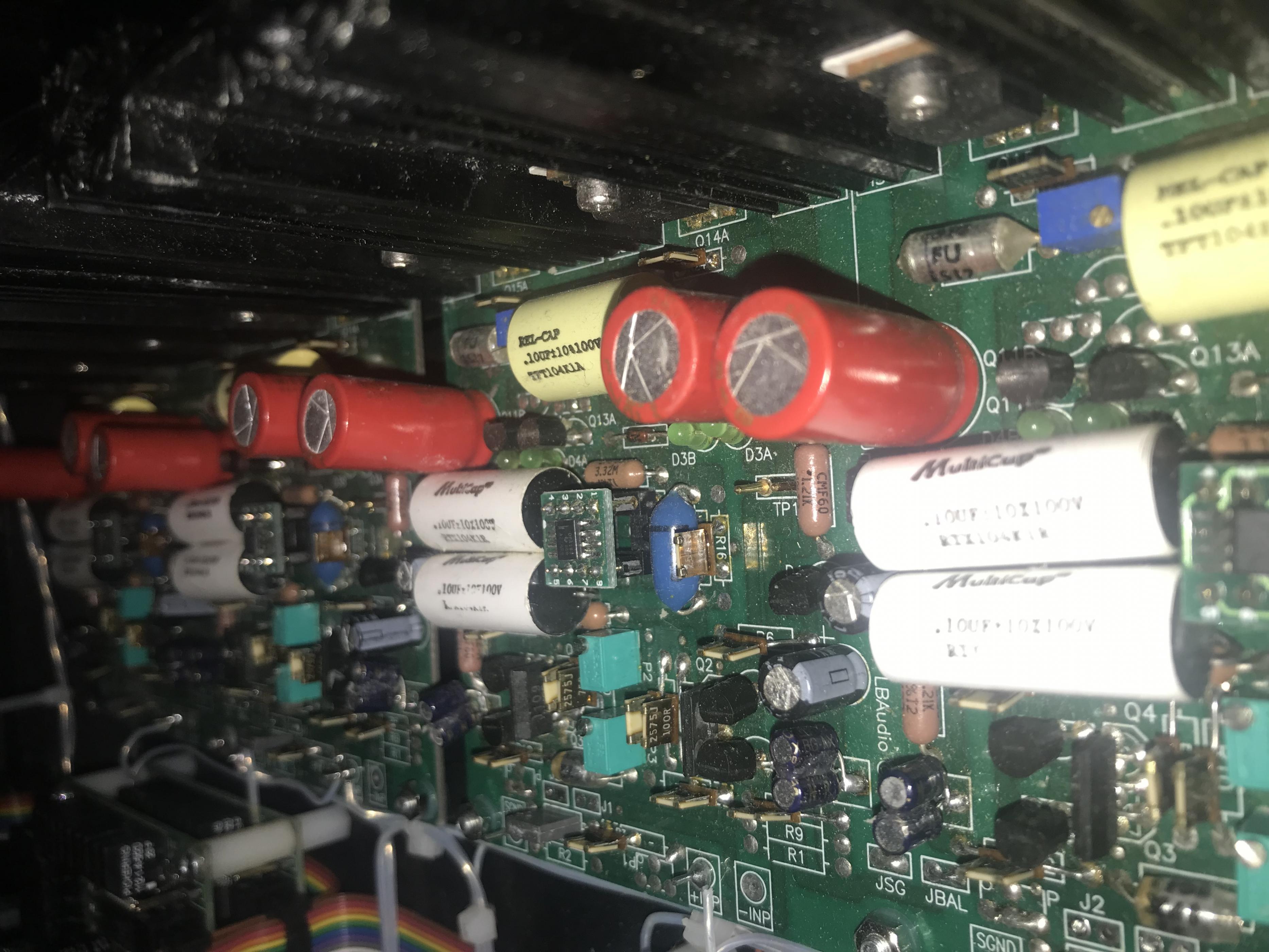

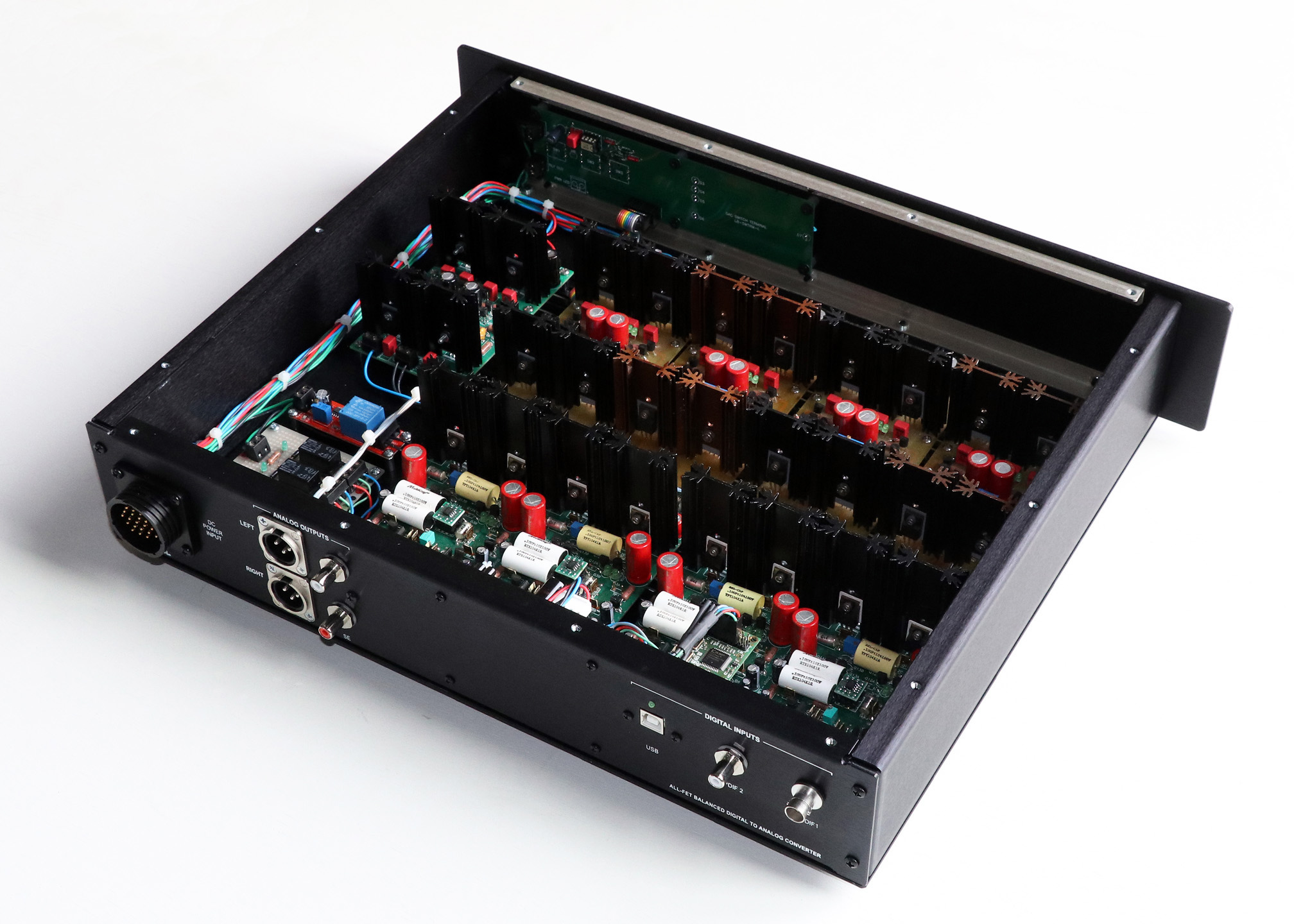

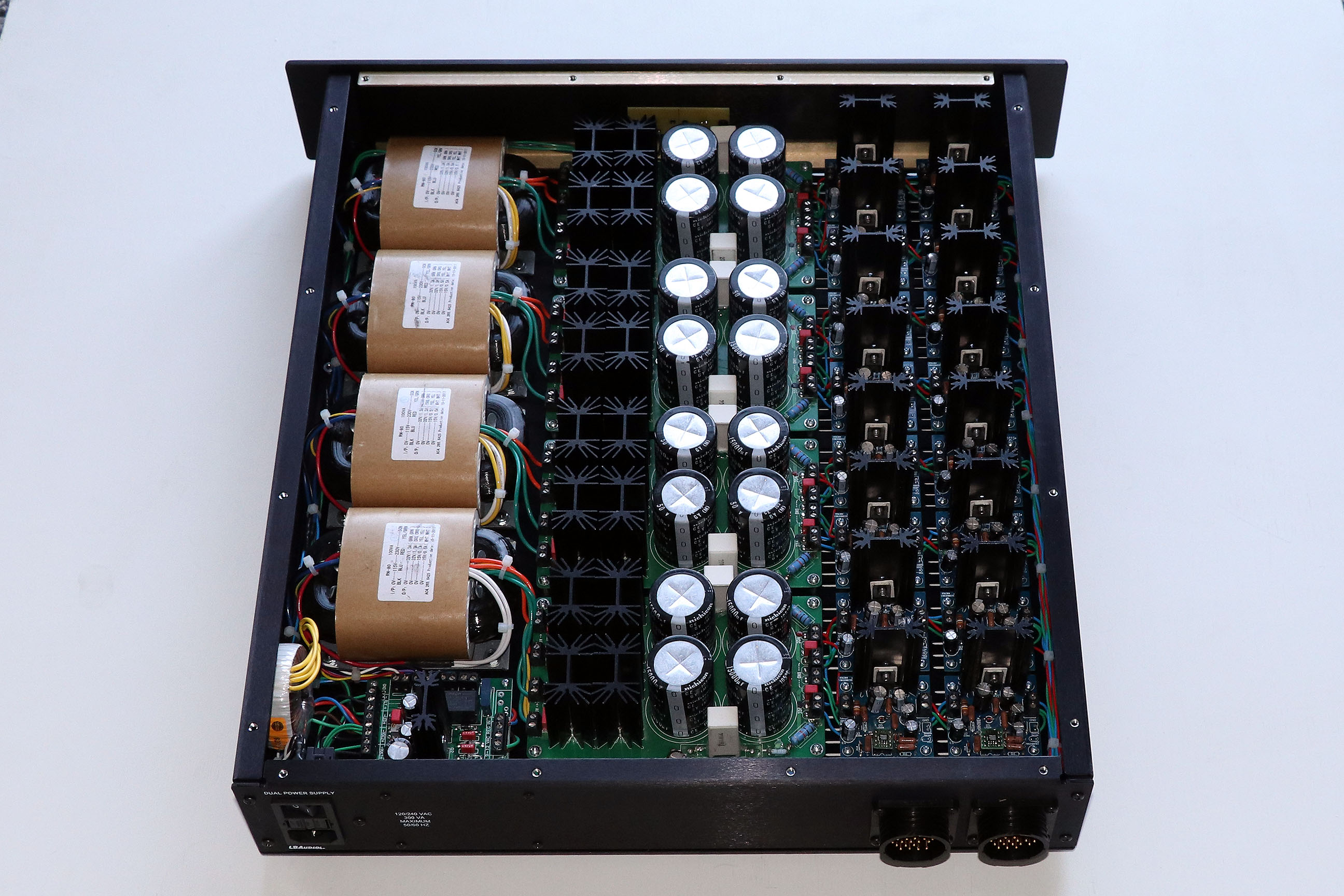

If its audio porn you want heres the balanced direct coupled 8 x 1704K 24/192 dac stage discrete jfet with 90ma biased fet output stage, nude Vishays, Blackgate N and NX Back to back for power supply, Relcap teflon bias bypass, MIT polystyrene caps with OPA 189 DC servos. The light blue trim pots are Bulk foil trimpots. Jung super regulators as preregulators before the shunts, hexfet bridges. discrete fet shunts regulators. R core transformers 240,000 uf CLC supply. Line stage and phono are identical in build components - now I have no money for software or records.......... .

goldnote uses them extensively. the red bright capacitors

funny. enjoy the unit nonetheless.
Are these products or a DIY build ?
The dac, line amp, and phono and shunt regulators are all Erno Borbely’s discrete jfet design. The raw power supply boards are DiyAudio power amp power supply boards that got used for line level electronics. I sourced the parts, built, and tested the boards. The chassis, mechanical design and assembly and wiring were done to a very high standard by Les Bordelon (LB Audio). They are all one of a kind diy. Here is the balanced line amp with remote controlled Bent audio reed relay stepped resistor volume control boards, the dac power supply is a separate chassis shown here, the preamp and phono power supply chassis was in post 1693 pictures. Theres over 100 of 3 inch high TO 220 heatsinks between the 3 units and their power supplies. Each runs high bias class A with 30 watts per channel dissipated. Direct coupled, all discrete Toshiba / Hitachi jfet/fet. over 80 % of the 2 chassis for each is power supply.
