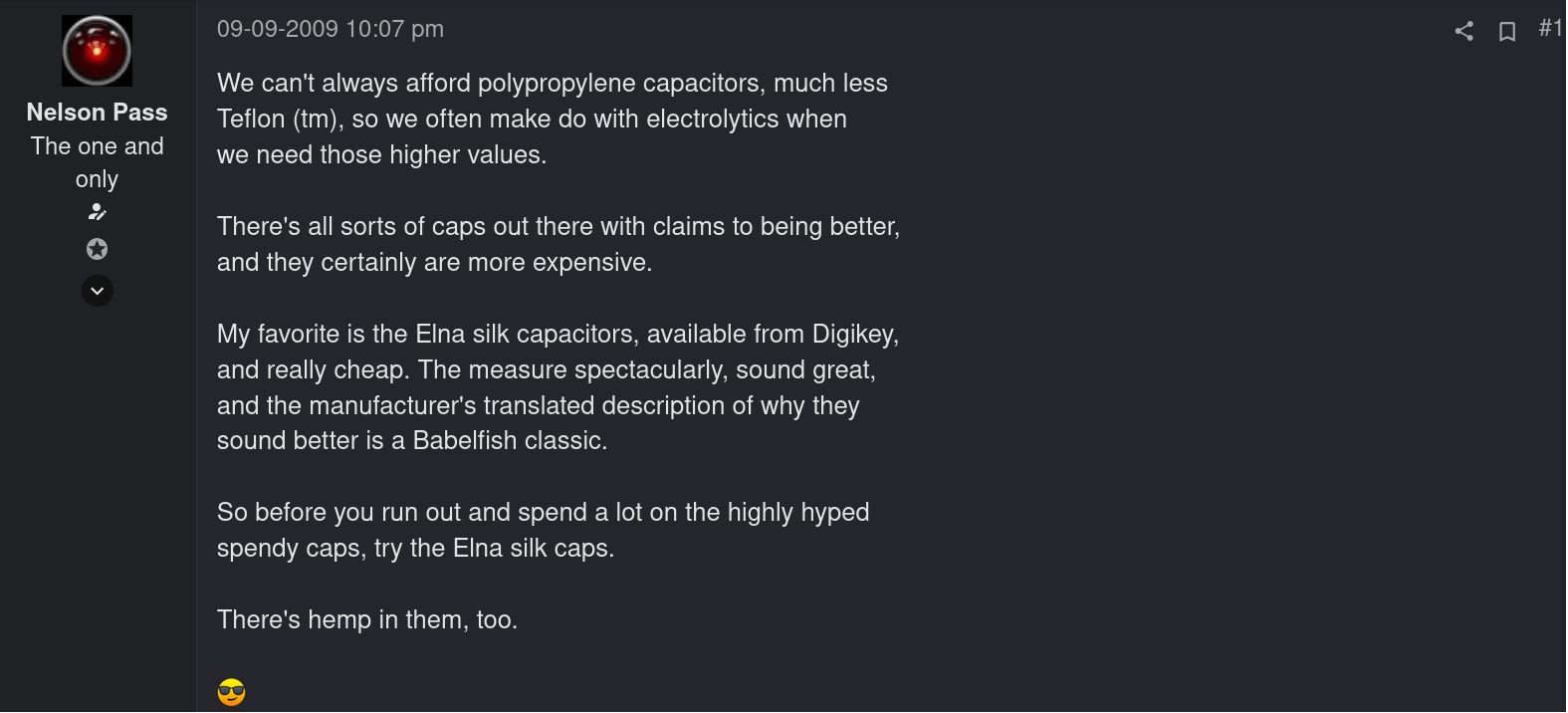

Hi nicoch58,
Nelson simply mentioned what he likes to use. Nothing about all the actual reasons for that at all. It is his opinion, which is valid for his personal reasons.
He did make an excellent point in that cost has little to do with performance, and also that manufacturer's descriptions can be utter nonsense.
I have met Nelson more than once and have great respect for the man. However that doesn't mean you need to fall all over yourself and accept what he or anyone else says without really looking into it.
-Chris

I think in a lot of situations, analogue and even some digital ELNA Silmics are very good, I'm interested in the reasons why, but quite happy to simply try, over time you do get a chance to try a number of caps. Some have been driven by views of people like Nelson, some by forum excitement and some by seeing what are used in components you like the sound of.
