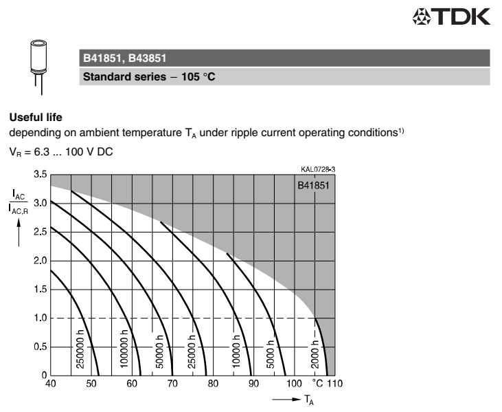

In switch mode, it's another story. But if you carefully engineer the circuit, by not stressing much the capacitors you can have good reliability.

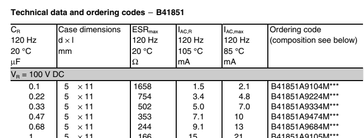

Main parameters are: ripple current (at specific frequency). temperature and expected life hours.
You can find these parameters in the datasheet and make the correct dimensioning of the capacitors.
Keep capacitors away of other heat sources, keep ripple current low and design for at least 30 years.
Example: if you estimate 2h per day use, you need to design the circuit to have current and temperature under the curve of 2*365*30 = 21.900h
And here's the trick: if you use higher current and higher temperature, so cutting cost, the circuit will work fine, but won't last 30 years, maybe just 10, 5 or 1.
And will depend on how much power the user will demand and at which ambient temperature the amp will be used.
Switch mode is a different world from AB class, where we normally didn't think about amp "wearing out".
In switching mode, it depends on how the design was made.
Just an example of what I'm talking about.
You take the IAC (ripple current) you plan to use and make the ratio with the IAC, R taken from the table for the specific cap value.
Then you go to the curve and select how many life hours you plan to have.
Here the designer makes the choice on how long the circuit will last.
