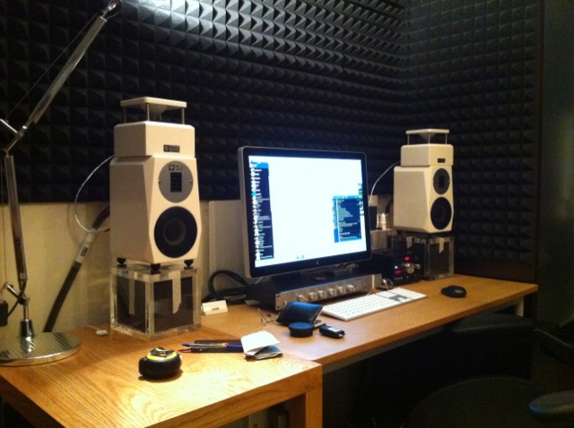

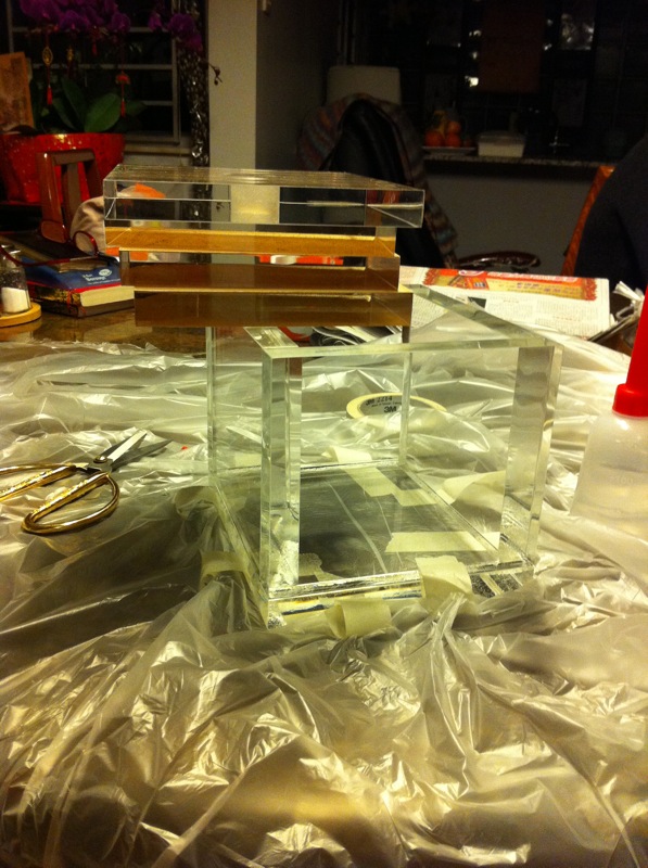

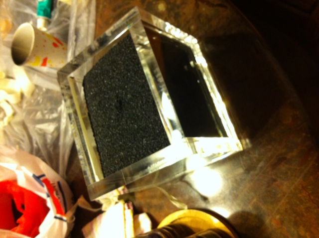

update
All i could find was "metal sand", which i believe it is used for road construction.
The enclosure is made of 1.8cm thick acrylic. Each block (with sand) weights around 19lbs.
And I'm happy to say the improvement is significant! The bass now sounds much tighter and cleaner than my solid wooden stand.
I will add some heavy-duty padding tomorrow and see if it will make any differences. I don't have time to remove the spikes and do further testing yet.
Hopefully, I will get to try out some marble enclosure and different type of sand soon. Again, thanks for all of the comments/suggestions. I am really happy with the result!
Here are some photos, enjoy!

URN SAND:
http://www.zorotools.com/g/Smoking Urn Sand/00008223/
Also, generally use it with a thin compliant layer for the sand to "push up" against.
I prefer rolled-on soft glue + cheap flannel sheets (as a fabric layer) glued to the cabinet walls where the sand will be poured.
