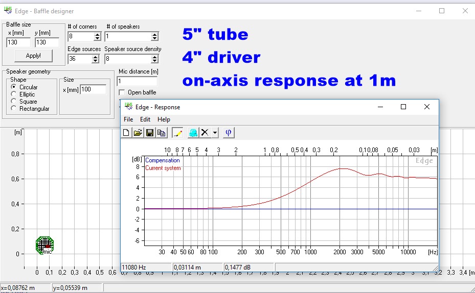

A tube with 5" outer diameter means that you must have a speaker driver that can be fitted in the end of it - so nominally a 4" driver. In that size there is no real benefit of using a coaxial, unless the unit will be part of a 3-way speker with separate bass unit.
The benefit of a tweeter comes from it's smaller diameter and therefore wider dispesion of high frequencies above 5khz. The area of the tweeter is off from bass-midrange driver's surface area, which greatly harms bass capabilities in this size range.
A round 5" baffle gives no support for bass, so the poor 4" driver will need 6dB of boost below 1kHz! Do not expect much better sound than a table radio gives... A high quality speaker design is extremely difficult bunch of restraints and compromises in this size! A dsp helps to get sound balance right, but distortion in bass can not be avoided.
