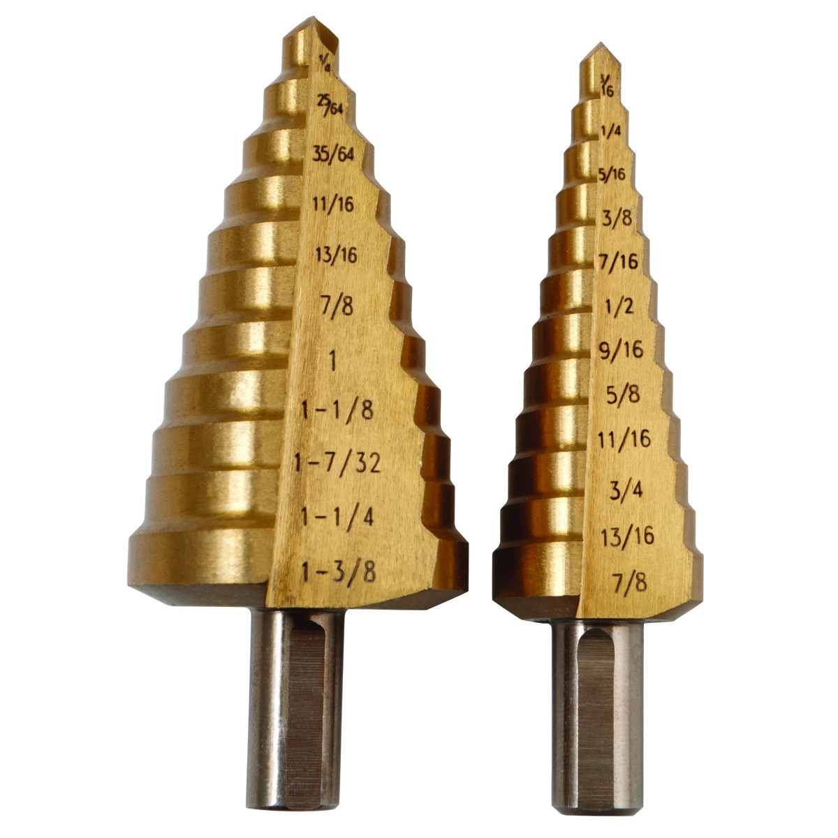

If you mean 1/2" holes through sheet metal I would just use one of these: Neiko Titanium Step Drill Bit - 1/4" to 1-3/8" in 1/8" Increments, 10 Steps - Amazon.com
Awesome; my next question was going to be "what type of bit should I use?" haha, so thanks! So the step bits are better for this than a regular split point?
It's going to be 1/2" holes through aluminum, like this aluminum box: Pedal Parts Plus: 1590NS {similar to Hammond 1590BB} UNFINISHED

I think it would work fine. With larger holes like this slow down the drill speed, don't get in a hurry. And I always use a cutting fluid called "Tap Magic", really saves your bits/taps. It's very wise to clamp down your workpiece to prevent the metal from catching/spinning/and then...injuring.
I use the neiko step bit mentioned above and also have a set of cheap harborfreight bits Steel Step Drill Set - 3 Piece, Titanium Nitride Step Drill Bits
Come to think of it, I also have a set of hole punches for when i need to make perfectly clean holes through soft material (such as tube sockets). Requires a bit of elbow grease though.
For larger holes. I've used hole saws in the drill lubricated by WD-40, making sure to clamp down the work piece securely

I always have to manually step up the sizes, Quite time consuming.
I also use a Tapered Reamer as well, and that works quite nicely !!

So I took the plunge. Based on all your recommendations, I ended up going with this drill: Milwaukee 0240-20 3/8-Inch Drill - Amazon.com (has a keyless chuck, and I own a lot of extension cords =))
I also got this step bit: Neiko Titanium Step Drill Bit - 1/4" to 1-3/8" in 1/8" Increments, 10 Steps - Amazon.com
I got the Tap Magic cutting fluid: Tap Magic 10016E Cutting Fluid - Amazon.com
And finally, to start the holes, I figured I'd try this automatic center punch: Lisle 30280 Automatic Center Punch : Amazon.com : Automotive (I probably could have just used a nail and hammer instead, but whatever, the center punch looked neat).
