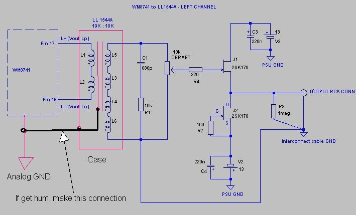

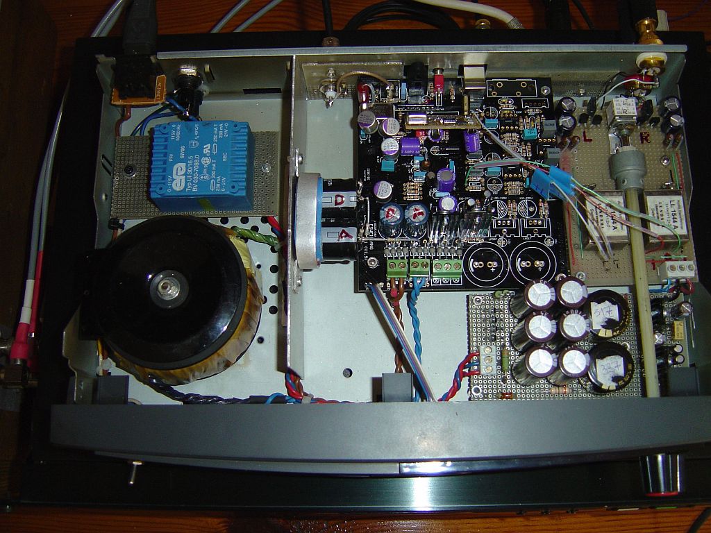

I use this for several years. It sounds very good.

Aha! Thank you RajkoM, that is very interesting to analyse and see the transformers in the output stage.
Did you make the output board with the Lundahl transformers yourself or buy it please (it looks a bit complex as opposed to connecting the transformers directly to the DAC output for me, at this stage...)

All on a universal PCBs is my own DIY.
DAC board is old Weiliang DAC-5 from China. Bought as a full kit and pretty tweaked (capacitors, resistors, regulators...)
2SK170 buffer has its own PSU with many CRCRCRC filters.
I suggest cermet volume pot. NOS german "Ruwido" pot is best to me, but current "Vishay" pot in a plastic housing is quite good.

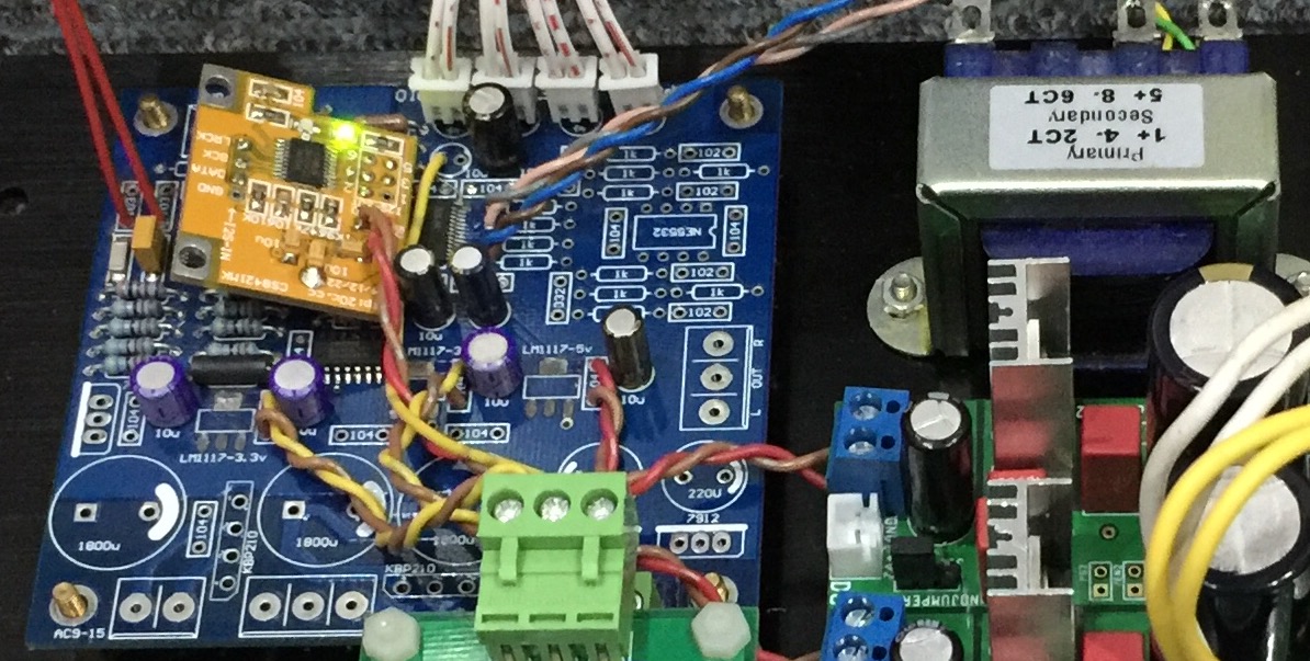

This is my Ak4396 dac with transformer output stage. I made a complicated power supply. It's a bit overkill.

I bought the pcb with the smd chips only and started from there. I use one power transformer with 4 separate secondary windings to make 4 independent power supplies. Two of them are based on LT3042 regulators bought from diyinhk. The other two uses LT1963 for pre-regulator and LT1763 on the second level.
FYI, I also add an upsampling chip cs8421 between the receiver chip and the dac chip. It upsample any input signal to 24/192.
