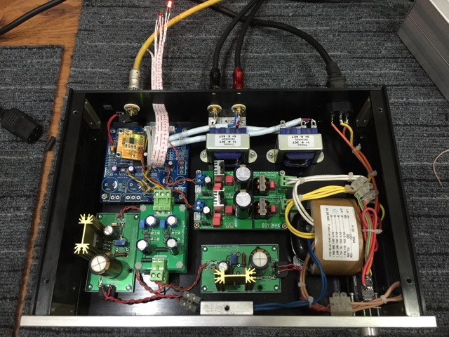

I recommend an akm based DAC and a pair of 1:1 transformers. You just connect the primary windingnof the transformer directly to the DAC chip. Put a 18k resistor across the secondary winding and connect to RCA output sockets. It's highly effective at reasonable cost. You can use edcor wsm600/600 transformers which is very cheap.

I believe wolfson chips are fine. I chose akm chip because they are saif to have lower high frequency noise so less filtering is needed at the analog stage. the output transformers would do enough filtering.
I use the transformers at the below link
https://www.don-audio.com/Edcor-WSM600-600?mt=1
There are better transformers but they are quite expensive and the difference in sound quality may not justifies the cost.
connection is really simple. you just connect two ends of the primary to the +/- pin of the dac chip.
Most dac have four resistors connecting the dac chip to the opamp. just pull out these resistors and connect the transformers to these points.
This is my Ak4396 dac with transformer output stage. I made a complicated power supply. It's a bit overkill.

It is my recommendation based on my actual experience. I have used opamp and I also have brand name products with opamps in the analog stage and they measured pretty well but they don't sound as good as a pair of transformers in this particular type of DAC (Vout).
decent transformers are totally transparent. Most quality studio equipment have line transformers inside. opamp performance is influenced by various factors most importantly the power supply for the opamp.
Current output DACs are different story.
FYI the edcore transformers have very suitable frequency response to use in the analoge stage of a Vout DAC and it form a natural low pass filter. This save you from having additional filter network that are normally added to the opamp.
The edcore transformer is down by -0.75db at 20khz and roll off quickly above 20khz. Using transformers with a much wider bandwidth then you loose this benefits of the natural LPF.
Are you sure that your DAC chip is OK with you almost shorting out its DC output with your transformer?
Also, are you sure that your transformers are OK with having DC applied to their coils? Is that not compromising their performance?
The +/- output pins of the chip have the same DC potential relative to ground therefore there is no dc running through the transformer primary. You can measure it if you have an ak4396 DAC
