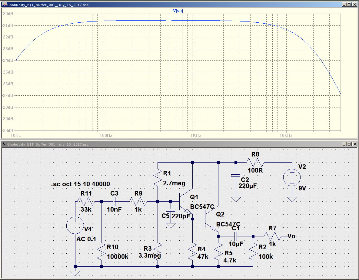

It looks as though the Darlington BJT booster concept has legs (see attached image). Input resistance is around 1.7 meg ohms, and no bootstrapping needed.
The input coupling capacitor probably should be bigger; that will lower the source impedance at low frequencies, which should reduce flicker noise.

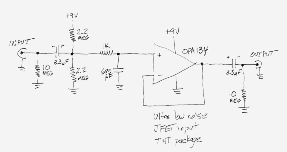

Why not use one of those genius-designed, super optimized Burr Brown opamps with ultra low noise JFET inputs?? OPA134 is available in both DIP-8 packages and surface mount; its noise is extremely low (8 nV/rt.Hz), and it's got JFET inputs with ultra low Ib spec so it can operate just fine with 1 megohm input impedance. What's not to like? And oh by the way, it's max supply voltage is 36V so you can run it off two 9V batteries in series, and guarantee yourself it'll never run out of headroom, even when the batteries are 95% discharged.
You can set the lowpass corner frequency wherever you please; in the attached schematic I've positioned it mighty doggone low.

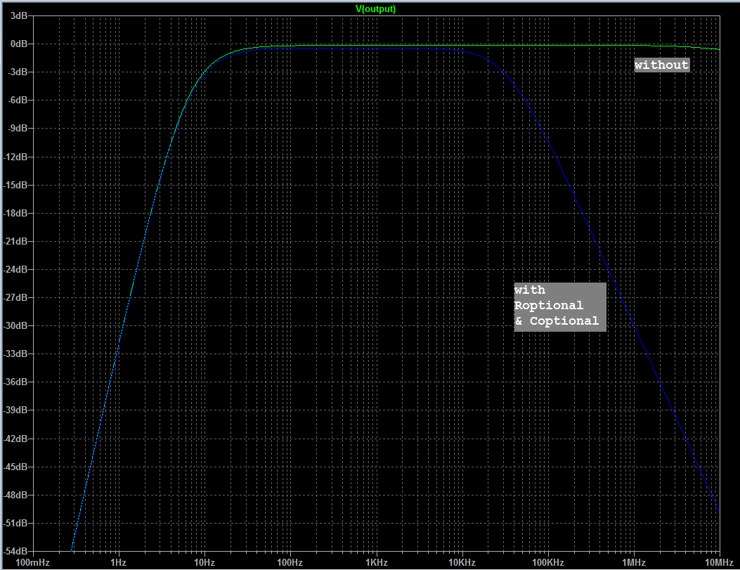

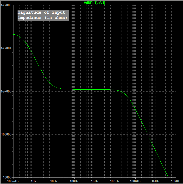

For those who prefer discrete components instead of ICs, here's a voltage follower with very wide output swing, Figure 1 below.
Don't be frightened by my squirrely use of scientific notation; R1 is simply 22 megohms and R4=1.2 megohms.
Input impedance is plotted in Figure 2; it remains above 1 megohm out to 20 kHz.
Frequency response is plotted in Figure 3. The green curve is the circuit's response when the optional components are omitted (Roptional = 0 ; Coptional = 0). The blue curve is the circuit's response when the optional components are included; the -3dB rolloff is about 30 kHz. You can finagle this by jacking around with the values of the optional components.
