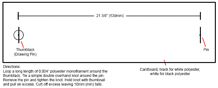

Hello,
For those, like me that cannot use tape for lack of space and must or prefer to use strings, here's the solution as published few years ago by Teres (if I remember well) before they started suggesting tape:
http://www.marinews.com/Double-Blood-Knot-251.php
Hope this helps....
Dario54
Hope this helps....
Dario54

I tried the following threads and the results are far better than the ordinary rubber/polymer belts.
1. Surgical silk
2. Nylon
3. Kevlar
Best regards,
Bins.
1. Surgical silk
2. Nylon
3. Kevlar
Best regards,
Bins.
Belt material
The old flat belt from SOTA was getting loose and slippy so I decided to try thread or string drive. Had to turn a new drive drum with a groove for the thread but that was quickly done. Then to try several different "strings". Most all worked well enough but the best I found is what WellTempered uses for the Amadeus TT, .004 transparent nylon thread by Coats thread company. (The spool I have is actually .005"). It took a few tries to get exactly the right length for no slippage but just enough "give" to let the synchronous motor start up reliably. Too tight and the motor won't start, too loose and it has trouble starting and slips. Get it right and it works very well. Besides it is soooo much cheaper and easier to get than the SOTA belt.
Bill
Bill
