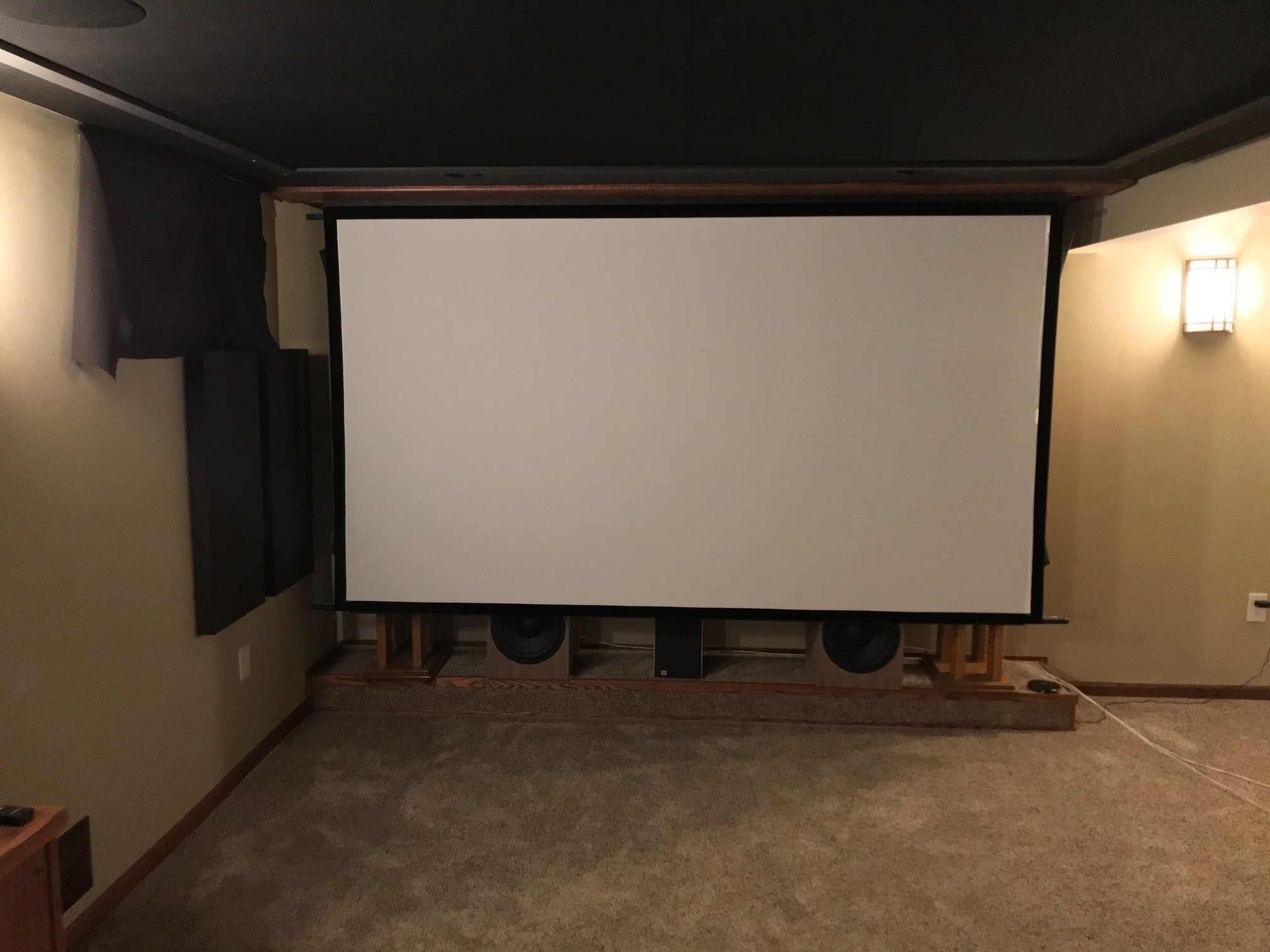

Current setup is a 120" screen so speakers are about 9 feet apart on center. I know it's not a very symmetrical setup with one speaker so close to the wall, so please factor that in.
23" from wall to back of screen
8" riser that speakers/stand will sit on
7 foot ceiling height
Seating distance from speakers is 12 feet.

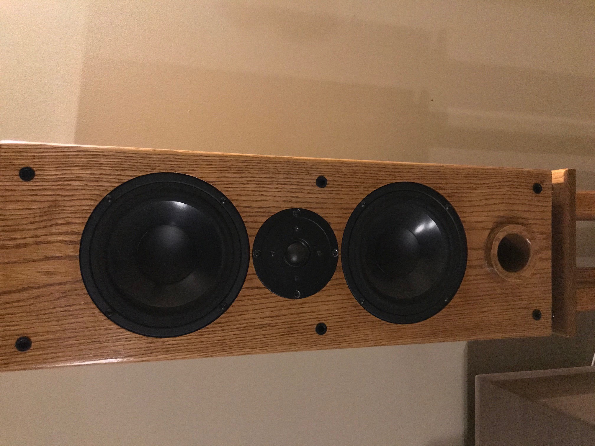

Main question is what design is best for my setup. Current speakers I built over 20 years ago. Peerless CSC 6.5" woofers and silk dome tweeter. Top woofer is ported in rear, bottom in front. Meniscus designed crossover using LEAP back then. Why I put one port in the back? Cause I wanted to lol. Not sure how this affects overall sound and response.
So what I want to know is what design would be best in my situation. Sealed design, ported, driver arrangement. I'm very open to most designs. It could be a WWMT tower, WWMTWW tower, simple 2 way with excellent imaging, 3 way, you name it.

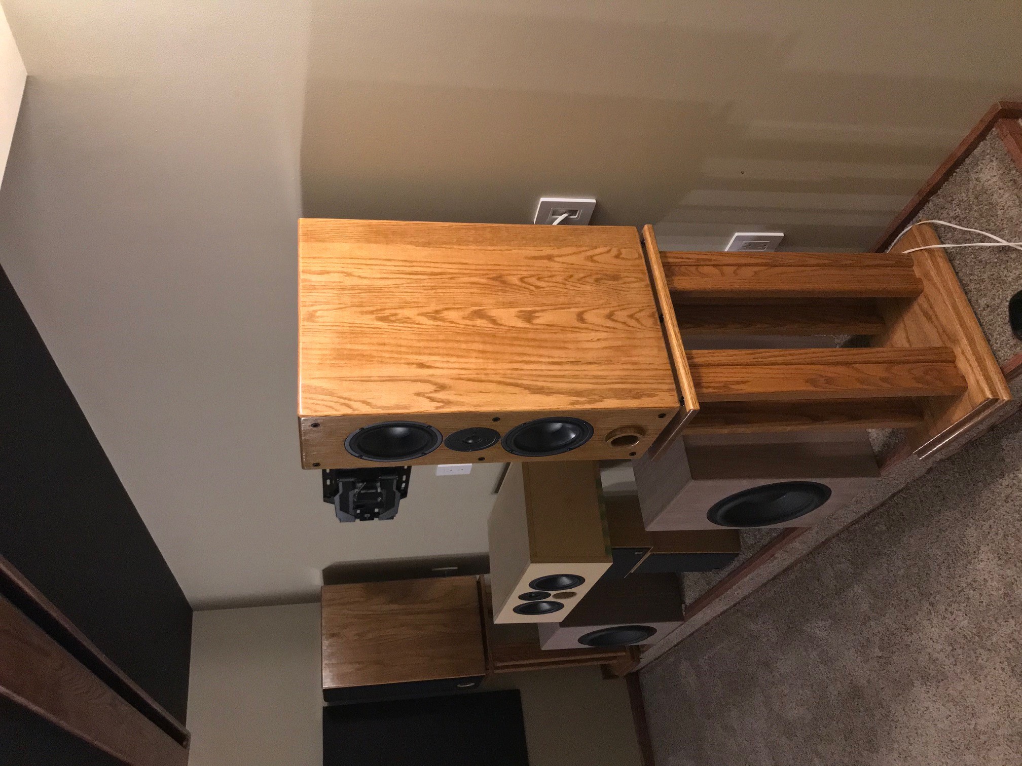

At times I do listen in Reference Stereo mode on my Emotiva XMC-1 through an Parasound A31 amp as the current MTM speakers do sound fantastic and reach pretty dang low. Many times I question if the subs are playing. Probably due to current placement boosting the low end? I'm sure the rear port (2" for both front and rear) being so close to the wall (maybe 3" away) isn't optimal as well as overall placement for these, though maybe I got lucky and won't do much better???

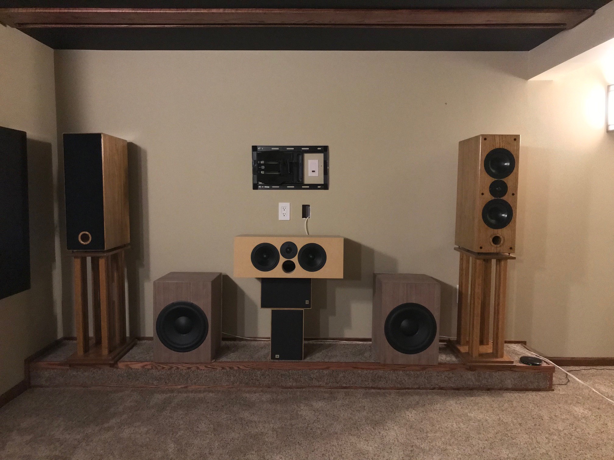

Center uses 6.5" Vifa drivers and silk dome tweeter with crossover recommended by Meniscus also, but built after the fact and never really finished off.
PLEASE NOTE!!!!! Willing to build a 3rd center that vertically matches the mains as I no longer have a TV mounted behind the screen and will be removing the mount. However I am almost always watching movies alone and sit in the sweet spot so a wide dispersion center is not really required.
I'm attaching a few pics for reference on what placement is and what I'm working with.
